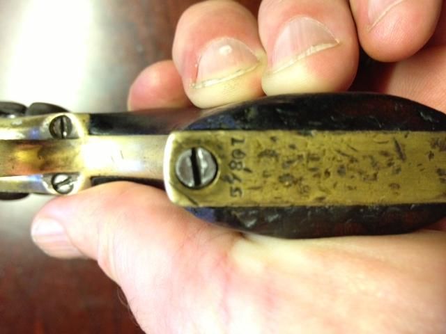

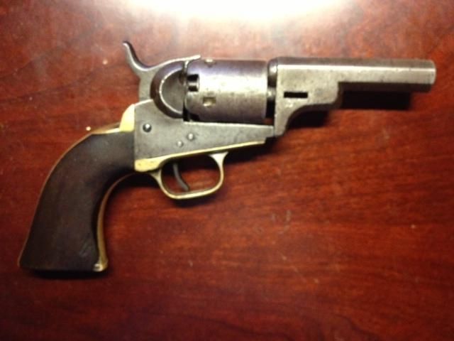

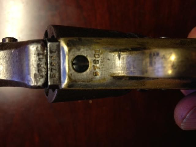

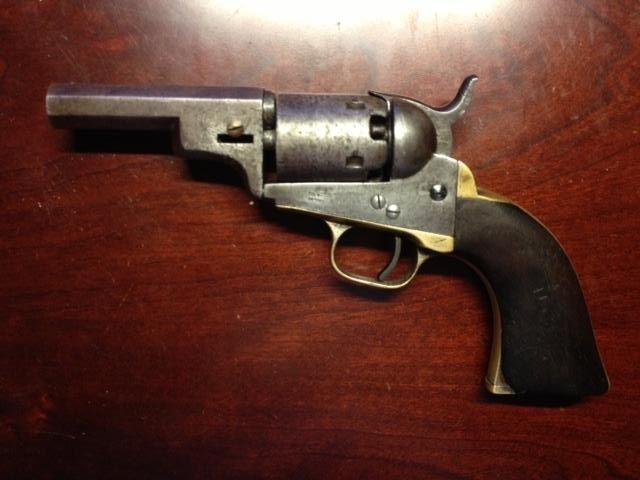

Here's another pistol I've been working on for a couple of weeks. When I got it, the hand was missing, the trigger spring was broken and all three side-facing frame screws (trigger, cylinder stop and hammer) were hopelessly buggered and tight-rusted in place, plus the trigger screw shaft was broken, allowing the trigger to flop around. The front trigger guard screw and wedge screw were also missing. With internal parts from Lodgewood and screws the previous owner had on hand, plus a LOT of patience to work the rusted screws out, I've pretty much got it back together. The wedge is still missing, and the grips have small pieces missing on both sides, but all the numbers (including arbor and cylinder) match.
This pistol dates from 1853 and I understand only 4,000 of them were made, so even with its warts I'm glad to have found it and own it.
This last picture shows (hopefully) what shape the screws were in

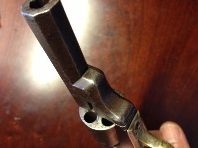

I fit the replacement wedge (Lodgewood) tonight. It required me to remove a little more material than I expected but I eventually got it to where it needed to be. I also used vinegar to remove the bluing from a couple of the screws and the wedge and got the color fairly consistent with the rest of the gun (compare to pics above). Fun project.
