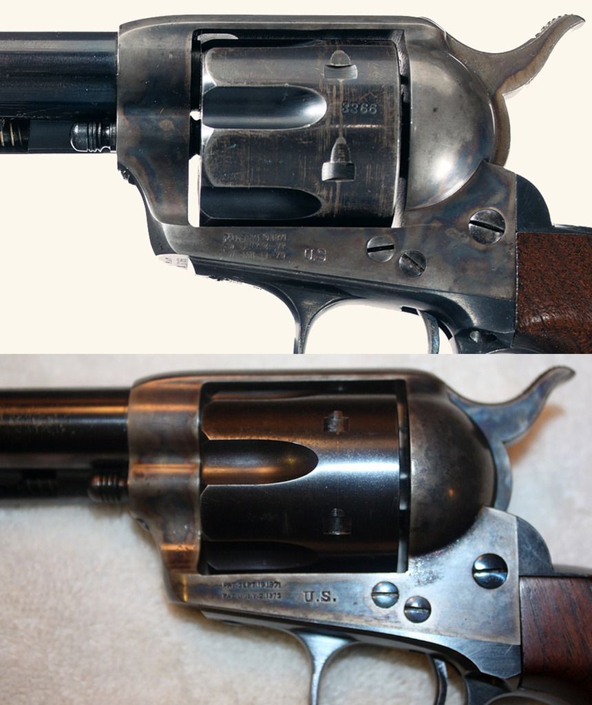

The cylinder looks odd. Maybe it is just because it is a really early one? But the notches look weird, and the front edge bevel doesn't look beveled enough.

I don't believe that cylinder is from a four digit U.S. Colt, and where is the cartouch ?

Here's a comparison image.
Wow, when compared to others that are early, the cylinder scalloping is indeed different. Makes it strongly possible this cylinder is not original to this particular firearm. Very good, and I missed this!
Unfortunately, this impacts the value somewhat more than immensely. Also, makes one wonder what else might be wrong with this firearm?
Rick - Glad you posted these two photos together! The first thing I noticed about the OP's revolver were the Flutes. You can sure see the difference in the two Cylinders.

I don't believe that that early a gun as the OP's should have any leads to the bolt notches at all.

The short lead-ins to the cylinder notches, the beveling on the front of the cylinder between the flutes, and the flutes are consistent with some images of early SAAs that I've seen in The Official Record of the Colt Single Action Army Revolver 1873 - 1895. There's a good image on page 49 with a cylinder that looks quite similar.
Best regards,
I googled several images of 4 digit examples and the flutes were more rounded at the rear
Why are there on 2 pat lines on the OP's gun? The one above has a serial number close to the OP's gun so you would think it would have 3 pat lines. Also the US stamp looks different. Just trying to learn here.
The SAA that Rick posted is not an early Ainsworth. I think he was simply trying to show
what a typical Cavalry might look like.

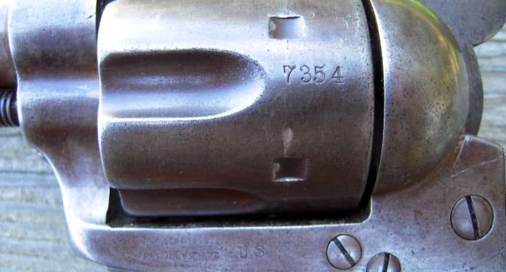

Here is an Ainsworth cylinder from an SAA in the 7xxx range:
