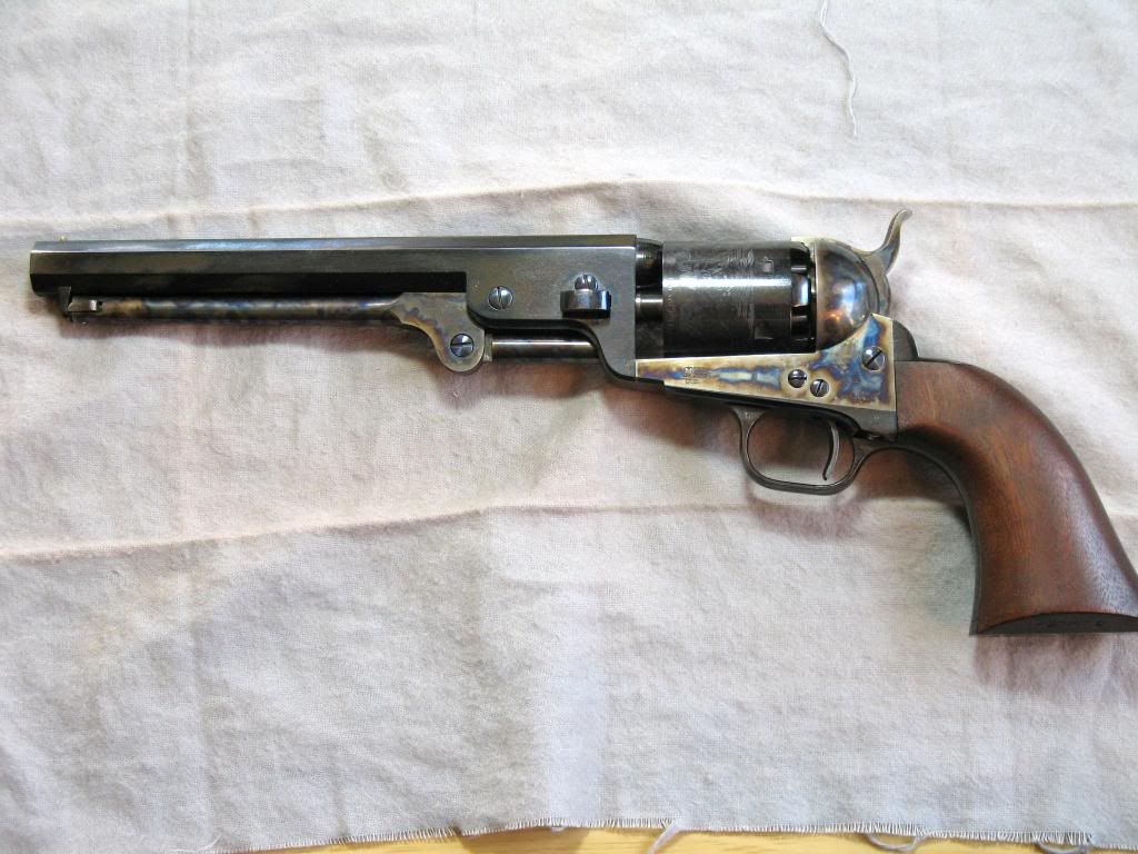

Gentlemen, this is a very long story which I will attempt to abrevieate for everyones sanity.

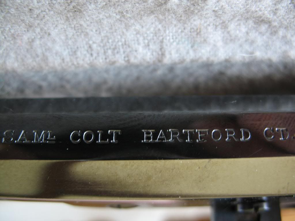

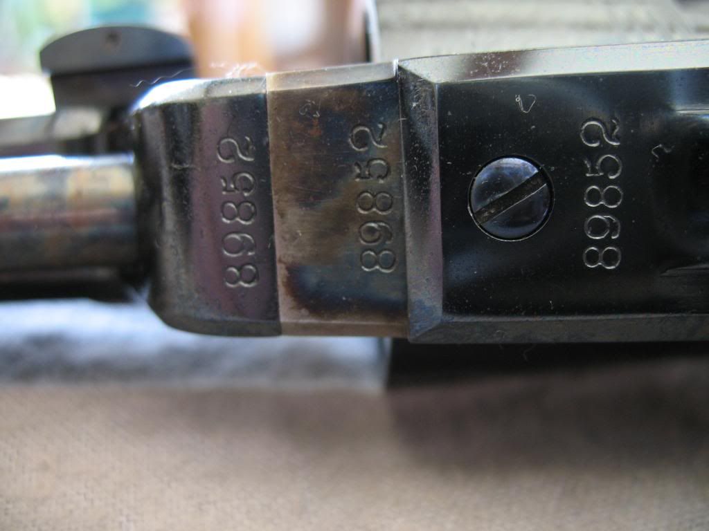

About 8 or 9 years ago, I purchased what was advertised as a Colt 2nd Generation Martial 1851 Navy. The seller was Collectors Firearms out of Texas with whom I have had numerous excellent purchases. I could not find the Martial model listed in Adler's book, but the photos looked great, and I knew I could return it with no issues. I was looking for an unabused shooter, so the fact that it did not have a box or papers didn't matter to me. The pistol arrived in due time, and I eagerly opened the box to view my prize. After a few seconds of admiring the perfect polishing and blueing, the old red flags started waving. This most certainly was NOT a second gen. Colt product. I have had a number of the 2nd Gen pistols and this looked nothing like them. The address was not one that Colt used in the 2nd or 3rd generation products.

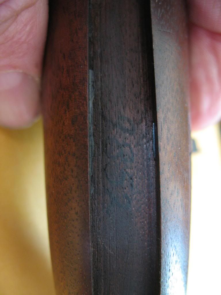

The finish was very high polish, with absolutely no overruns or welling around holes or loss of sharpness in the edges. An amazing and expert job every where I could look. I am a good judge of metal work (former QA guy for Shiloh Rifle Co. 16yrs) and whoever did the metalwork was "top shelf". I carefully disassembled the pistol to see if I could find any markings or a signature stamp. What I found was that the pistol has no areas that show evidence of casting. All internal surfaces are filed, polished, or milled. There are inspectors stamps in places that don't show without disassembling the pistol (in the cut for the loading lever pivot under the barrel, on the standing breech of the receiver, on the underside of the cylinder pin) Most exhibit "proud" metal around the stamps. I grabbed my copy of Swayze's book on '51 Navies, and began to dissect the pistol piece by piece. After a few days of research, I think what I have is a very good condition original Navy/Navy with an almost flawless restoration job or... an outright, full on fake, made of one or more original Colt 1851s melded together by some master restorer to produce a very rare M1851 variation ( a small iron guard, early "late model" Navy/Navy). I know by actual comparison, that the cylinder scene is the one produced from the roll die that belonged to Tom Haas Sr. and used in his shops restorations.

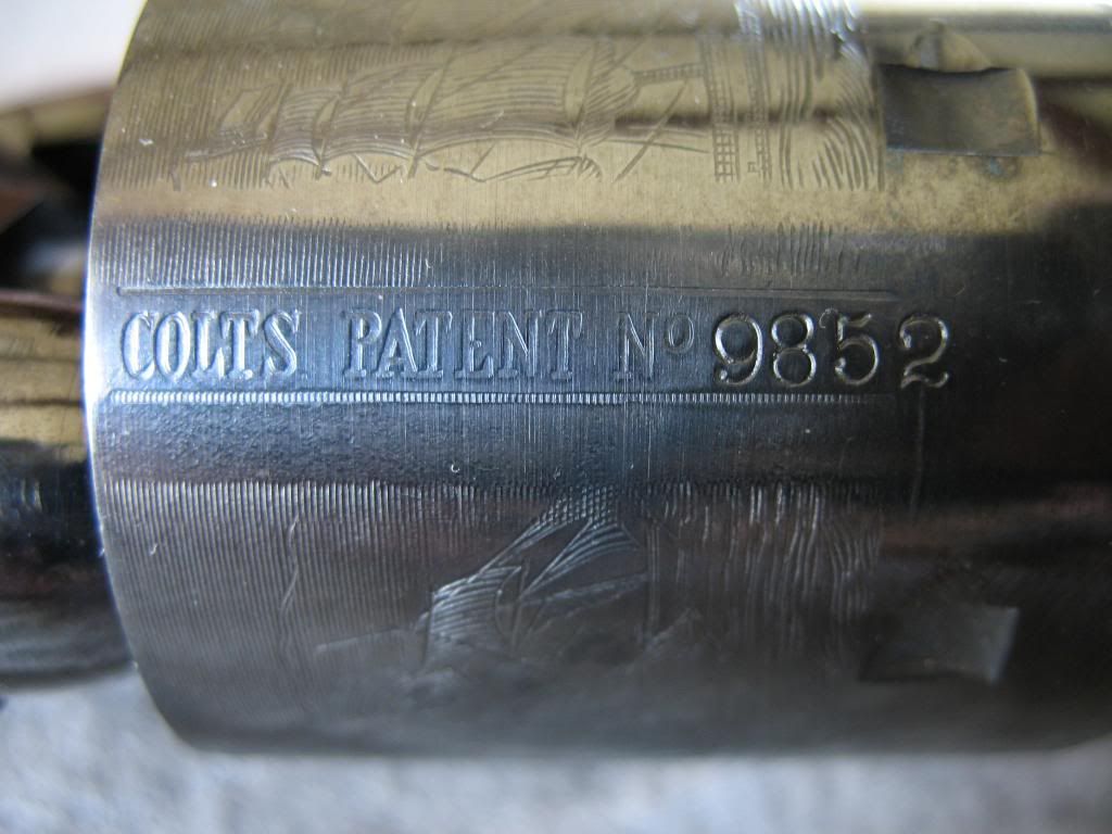

Plate 49 on page 90 of Swayze's shows his Navy/Navy ser. # 89851. Mine is #89852....Hhmmm...pretty remarkable coincidence.
One more.
I called Collectors, as I was sure it was worth a lot more than the 2nd Generation Colt I thought I was buying. They really weren't interested in it, and only told me that I could return it if I wasn't satisfied.....I was so intrigued by it, I decided to keep it.
I have no idea what it is worth, but would sure like to hear some opinions from the forum.
I had originally discussed this pistol on another forum back in 2009, but had no way to post pictures. I see some of the same usernames here, so I apologize to Steg and a few others for dredging this subject up again. If anyone needs other photos of specific parts, I have taken hundreds of this pistol that I could share
Thanks for any and all comments
Tom W.

I too suspect that Acevedo was the restorer/creator of this interesting piece. I did contact the family through the website and some months later received an email from them saying they did not have the records showing this piece. I got the impression that they only had a partial list. I would love to know everyones thoughts on:
-who made this piece
-is there any chance this could actually be a completely restored #89852
-what kind of cost to have this work performed
-what kind of worth to attach to it.
I have left the Photobucket link to this pistol "public" so feel free to click on the pictures to pull up the file for it. The photos there are expandable for detail.

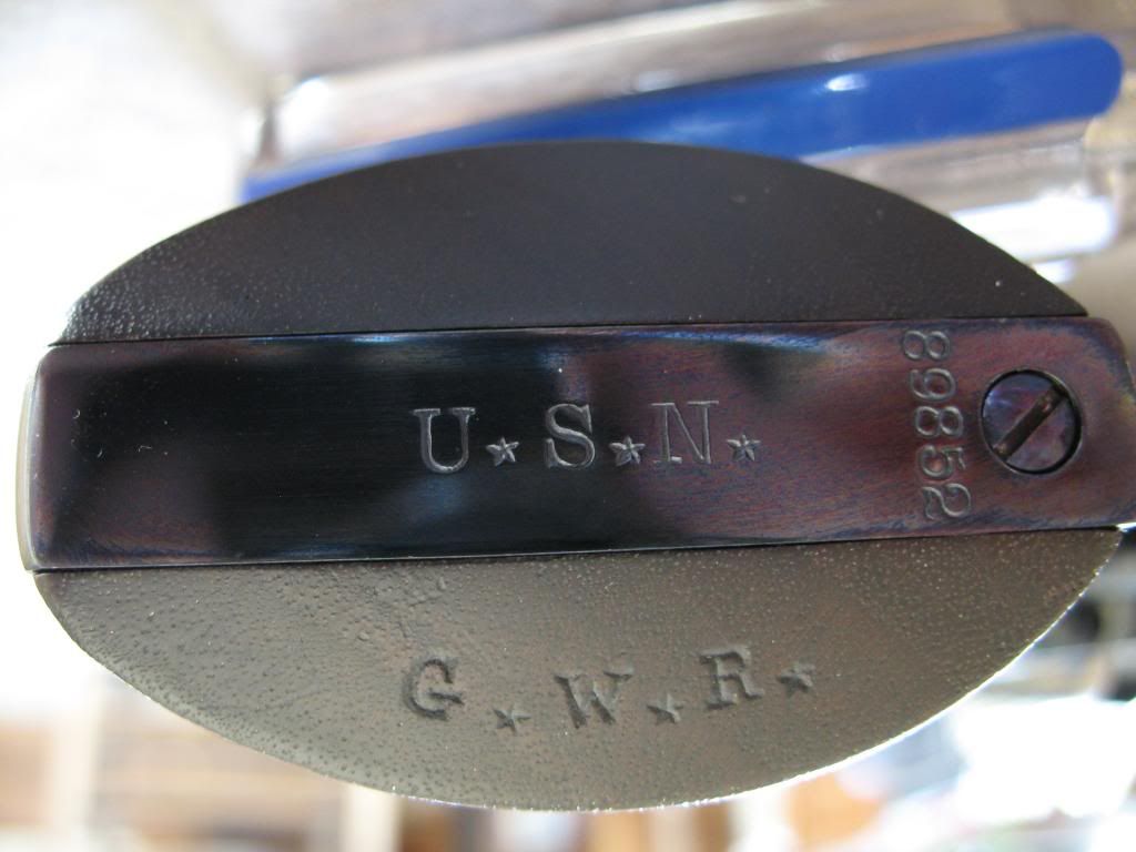

Just a few more...
Star or asterisk on cylinder face.
One of the inspectors stamps.
Navy anchor stamp at breech end of barrel.
Thanks for all comments!

It's very nice looking. I think you've decided it's not the original finish from the mid 1800s, and I agree. Not because i'm an expert in finishes (like you!), but just because there is NO wear anywhere. The frame screws are so sharp they'd cut you, there isn't even any smoothing from 150 years of handling - anywhere. So I'm with you, it was done much more recently.
1,046 Posts
Very beautiful, and I agree it's probably from the Acevedo shop. I've had the pleasure of being a past owner of both a Haas Whitneyville Transition Dragoon and one of his Walkers, and your Navy has the all the hallmarks of the type of workmanship on those two pieces. Years ago when I owned them, the Dragoon I believe went for about $4000, & the Walker maybe a couple thousand more than that. Would guess an easy $2-3 thousand for this one, IF it could be proven to be a Haas/Acevedo creation. If you ever want to part with it...............

Secondly, I am not an expert on antique Colt finishes (wish I was), but do have extensive experience with hand polished metal work. I wish I could have tied this piece to the Haas/Acevedo works, but have had no luck with any kind of written documentation and not sure where to look next. Desron6's comments on his own pieces is about the most concrete link I have...I have no intention of selling the piece at this time, but like to keep my insurance coverage up to snuff (as I bet you all do !). It is most definitely not an 1850's Colt blue, but a well placed Colt Collector said it was certainly a great copy of the 1890's Colt process. I know that the Haas/Acevedo shop was able to produce that color on some DFC era military SAA's so that still "clicks".

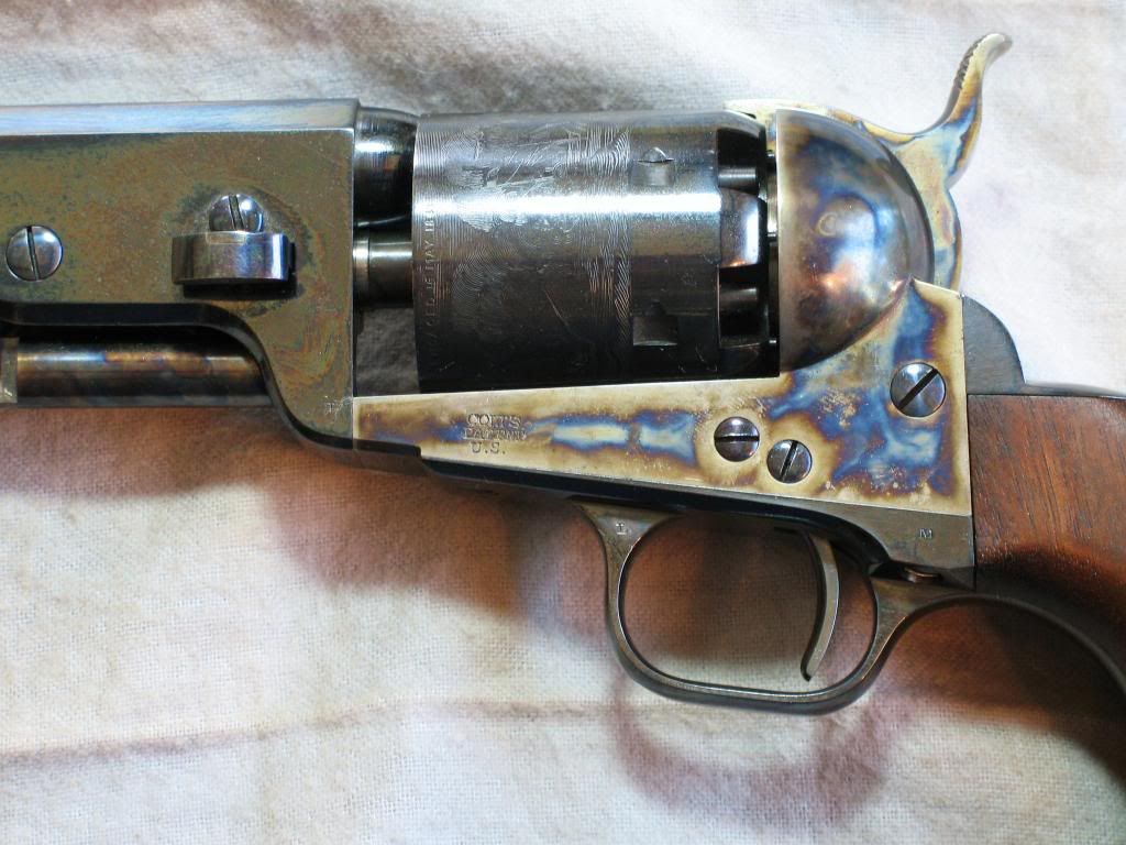

photo (30).jpg That's a stunning 51 you have. Looking closely at your photos the machining and general fit of all parts does lean towards it being a refinished original. Modern copies just don't have that level of detail. Whoever did the case hardening really knew what he was doing. Probably the closest I've seen to Colt's colours. Over some years I've been working on a Uberti 51. I'm not a professional but decided to see if I could replicate the finishes from 19C Colt. I found that the most difficult skill to master is polishing. It's relatively easy to make steel shiny. However, to bring the polish to a mirror finish without rounding edges takes a long time to master. I ended up gluing different grades of emery paper to small flat steel backing plates to suit specific areas of the gun whilst polishing. I found wooden backing to be too soft and would compress, - causing rounded edges. Anyway, other than the case hardening, which was done by Turnbull, I finished the rest. I only have the one photo at this time but I hope you can see the detail.
