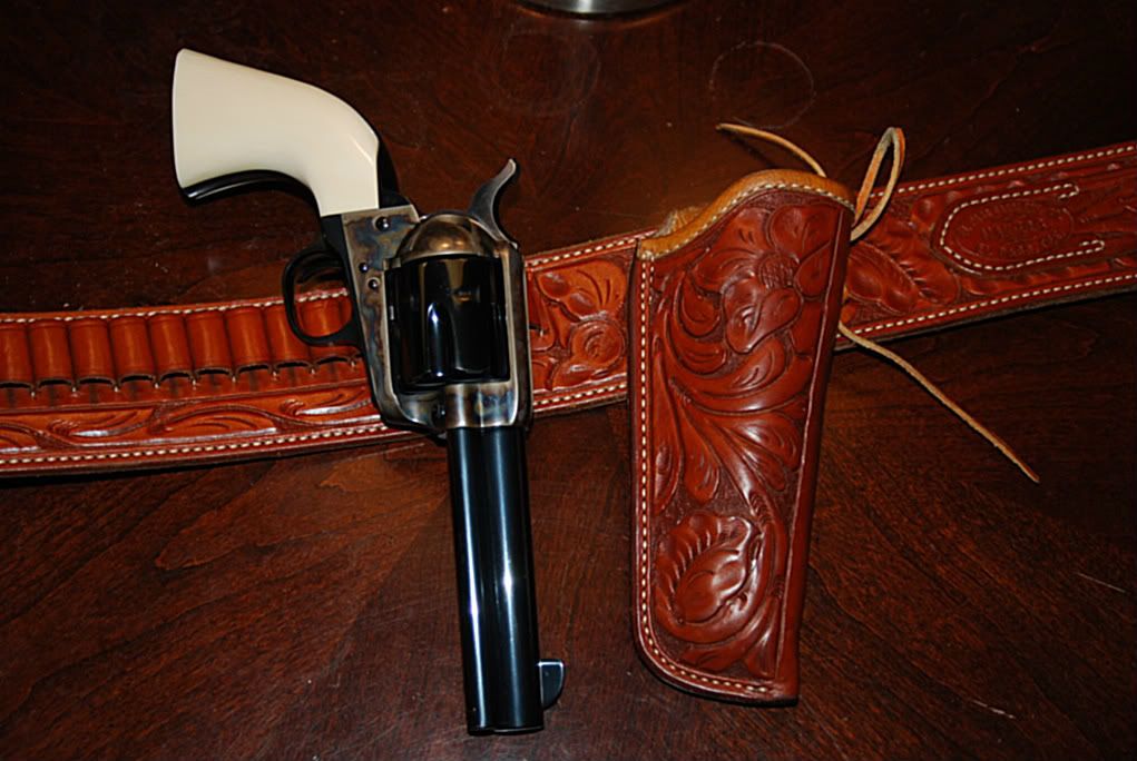

I bought this one new in 2007 and shot it for about 600-800 rounds before I sent it to Hamilton Bowen to have a few things done including a trigger job. In speaking with Mr. Bowen I found out that the internals got battered pretty good from shooting it so it needed a new trigger and hand. Although the parts were relatively inexpensive to replace, I found it to be a valuable lessen. All of my SAA 's now receive a trigger job prior to shooting.

It appears Bowen's observation of battered parts after 6-800 rounds is a solid testimonial that speaks for itself about using the gun with factory springs for any length of time. This pretty much substantiates the "turn 1st" concept that several have espoused. But everybody ought to do whatever they want with their own guns.
