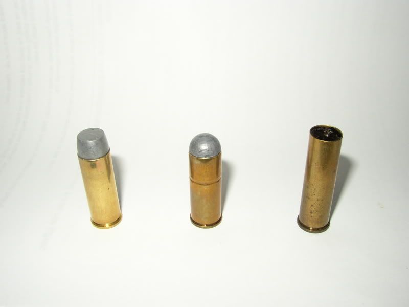

I make my own out of 444 Marlin cases trimed to cylinder length. The case Dia. and rim dia. are so close, they work great. Trim to cylinder length, prime, (i use 5 gr. Herco) fill with shot (I've got a stash of #12) on top of a card wad, another card wad on top, and a touch of fingernail polish to seal. they carry a lot of shot, do not lead much at all, and are snake busters out to 15' The center in this pic is one of my twin .454 lead ball loads which prints about 3" apart at 30'.
