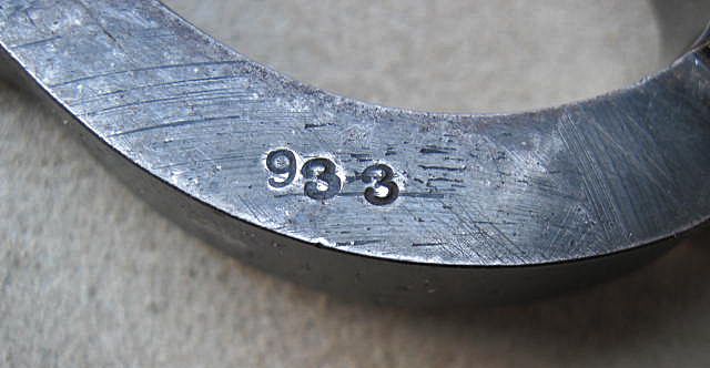

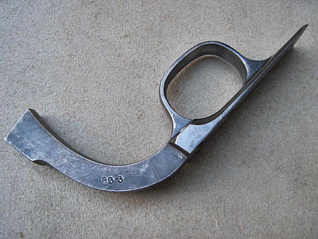

There will be some numbers stamped on the grip frame under the grips and/or an ampersand or star on the right rear trigger guard flat. The pictured numbers indicate that Colt did some work on this gun in September of 1933.
I have never heard of this being a Month/Year code before. I have seen multiple examples where that doesn't quite work. One that is referenced in print is serial 342,478. It has a work/refinish number of 1004. It is a 1920-21 gun and I know it was not refinished in Oct. 2004?
