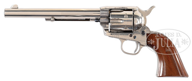

What I'd like to have...

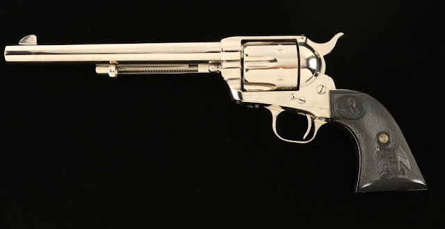

And what I have now...
More of an original
Early Colt Frontier Six Shooter Etched Panel Single Action Army Revolver, #75398, .44-40 cal., 7-1/2'' barrel, nickel finish, blue screws and trigger, case hardened hammer, with one-piece varnished walnut grips. Mfg'd 1882. (Box top appears to be a good quality reproduction; bottom half is new.) Condition is excellent with light even toning to nickel. Fire blued screws remain bright. Etched panel remains clear. Cylinder axle shows marring with scuffs and scratches to bottom portion of barrel just forward of axle. Grips with losses to finish at high edge near butt with minor scuffing and showing at least 90% varnish. Action is tight and solid with bright bore. A beautiful early etched panel revolver. Est.: $10,000-$15,000.

OK, I need a new etched panel barrel and correctly profiled front sight to get started. Figure Dave Lanara can make me up exactly what I need :)
Nutmeg can nickel anything I need nickeled. Trigger guard and back strap will require new nickel once I cut into them while fitting once piece walnut grips. Already bought some of Lanara's 100 year of walnut blanks for this project. I can nitre blue my own screws but thinking just a new set of polished blue Colt screws will be a better match from the pictures I have seen.
Hondo's list for the 45 of the Centennial Pair. I wonder how the list compares to on the nickel 44 Centennial gun?.
