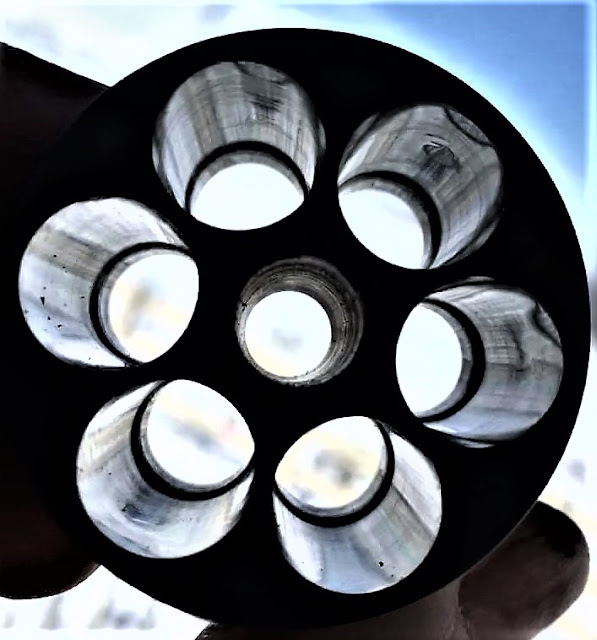

Since Sixguns asked on another thread here is the story.
I've seen it mentioned here at least once that someone was shooting their S&W or Ruger in .45 Colt or 44 Special using a "mild" load that wouldn't extract from their Colt.
I first found that to be true in a new 44 Special, Colt Single Action Army. Cylinder looked good on inspection but the cases had to be pounded out on some of the cylinder's chambers where they would fall out of my S&W. I couldn't easily see anything and the cases looked normal when they came out of the gun. I finally just replaced the cylinder and everything was fine. I still shoot that gun a lot. I later used that same out of spec 44 Special cylinder for a custom cut .45 cylinder.
On the .45 cylinder shown above I was loading what I had thought was a light load of WW231. A load i had shoot a lot of in a S&W .45s and a USFA. WW231 is a fine grain, fast powder and likely one of the worst you can use in the huge .45 Colt case. When I fired the round that made the biggest bulge you see on the locking slot, I felt the difference in recoil. Nothing traumatic but more recoil than normal. Thought that odd as I reload on a progressive machine with very accurate powder drops. Three of the rounds were sticky on extraction. The fourth had to be pounded out. Still clueless as to what happened, on the next full cylinder I noted the gun couldn't be cycled normally as the bolt wouldn't go into lock up on the worst of the cylinders. Slow I know but at that point I finally tore the gun apart and inspected the damage.
No question the cylinder is now unusable and unsafe.
While I certainly could have just set my powder drop incorrectly, and likely did to cause this damage, I did go back and check and spend some time pondering the result. My powder charge wasn't listed as anything close to max. The conclusion I came to was to no longer use 231 in the big Colt case. I use Unique specifically for the . 45 Colt now, but Trail Boss is a better answer I think just not as economical to load the high numbers I want to shoot. As anecdotal evidence to just how weak a Colt .45 cylinder is I had two locking notches budge on another new Colt that I intentionally only used factory ammo in a few years later. Again the sign that it had happened was sticky extraction. Nothing really serious this time and the cylinder is still usable, I had it replaced anyway. But once I knew what to look for, the lock slot bulge was obvious. That gun was shipped from Colt "in the white" and have always wondered if that cylinder missed heat treat.

Yep light loads in big cases can cause a huge pressure spike and blow a gun..Kaboom! Was first seen I think in 38 cases using Bullseye. Any case that was intended for BP originally is suspect. I'd bet the .41 mag case would act in a similar manner.
You need to consider the possibility of a double charge. It is something that can happen with a progressive if you somehow get off "rhythm". I've been using W-231 in a the 45 Colt for about 15 years now (7.0 grains with various 250-260 grain bullets) and (just once, thank god) experienced what you did. I had to get a new cylinder but every thing else was OK. Somehow when I loaded that batch of ammo on my Dillon 550 I got distracted/lost my rhythm and did a double charge - oops! It is easy to get into sync on a progressive and if anything goes amiss make a mistake. I am a careful and conscientious reloader but I am a human being. If something - anything! - seems even a little off stop and check and make sure. Hard earned experience speaking here...

Good point Sir Colt! And I certainly respect your own experience. Two things would have me think other wise on a dbl charge here though. Although I have a 550 I don't typically load any pistol ammo on it besides 32-20. I had run 1000s of 45 Colt loads with 231 prior and only one issue years prior....likely a dbl loaded on a 550. Which destroyed the gun.
All my 45 ammo gets loaded on a 1050 and is the machine that loaded for the blown cylinder. A dbl charge is possible but much, much more unlikely on a 1050. Also it would have been 4 double charges out of 6 and although a dbl charge is not beyond me, four in a row is really doubtful. I had other Colts' on the bench that day and was shooting the same ammo prior and continued shooting other guns after with that same ammo that blew the cylinder.
Been awhile since that happened and I don't remember if I was tryin to run a really light load or simply mis-measured the powder when setting up the machine. Something was wrong and I certainly didn't trust that batch of ammo so the rest was shot up in a rifle. But hard to believe even then I was running that far past 7 or 7.5 of 231 to cause the damage I did as 8 gr being at least one accepted max in a SAA. 14 or 15 gr would likely have destroyed the gun.
I've seen 2 KaBooms from small charges of powder in big cases that could be more easily explained as dbl charges. But I have also seen and felt known dbl charges (off a 550 actually :) Either way I know folks use and love 231 or HP38. I do as well just no longer a fan of either...in a 45 Colt.
