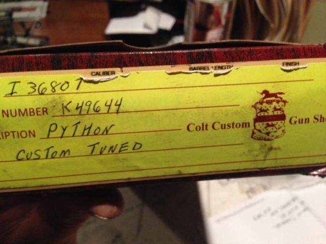

This one is as real as they get. 1978 vintage. Original owner had it for 25 years and I have had it for 10. Chain of custody has been pretty tight so I would safely say that its good.
Text Label
With that evidence, I am now inclined to say the subject box label is original. It is the right color and the handwritten format is the same as the 1978 vintage box immediately above. Apparently, the typed labels came later than 1978. Since the 8-inch Python was introduced in 1980, and my typed Custom Shop label is from 1981, that leaves a one-year window for the subject gun to have the handwritten label. Certainly possible.

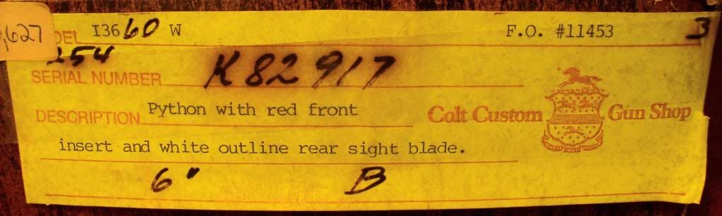

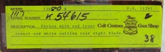

The subject label, in photo # 2, is one that I would conclude is fake if I were looking at this Python to purchase. The Custom Shop labels from this time frame (1981) that I own or have photos of, are structured differently, with specific data, such as Factory Order Number and other codes, and some information typed. These known originals are shown in Photos 1, 3 and 4. Notice the similarities of the known originals, and how each differs from the subject.

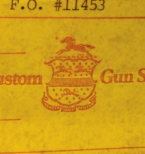

Now going a step further, I compared the Coat of Arms in the subject label with my known originals and there seems to be some very distinct differences; enough of a difference that I would be highly suspicious of the subject label. Photo # 4 is a blow-up of a known original. Examine and compare the "shading" dots and the lower banner, as these are quite different and can't be a result of printer definition or copy clarity. Take a close look and tell us if you agree.
So the question was asked: is this a "correct Python box label?". It is sometimes impossible to know with 100% certainty when judging fake versus original Python labels and this one is such a case. Judging the label would have been easier if we could also examine the box and it contents for authenticity. Of course a fake box would also lead us to a near 100% fake label. With only the label, and its comparison to known originals, I found enough differences to guess the label is a reproduction. I certainly would not pay a "Custom Shop" premium for the Python.
PHOTO # 1: (Known Original From 1981)
PHOTO # 2: (Subject Label - Me Thinks It Stinks)
PHOTO # 3: (Known Original From 1982)
PHOTO # 4: (Close Up Of Coat of Arms From 1982 Known Original)
