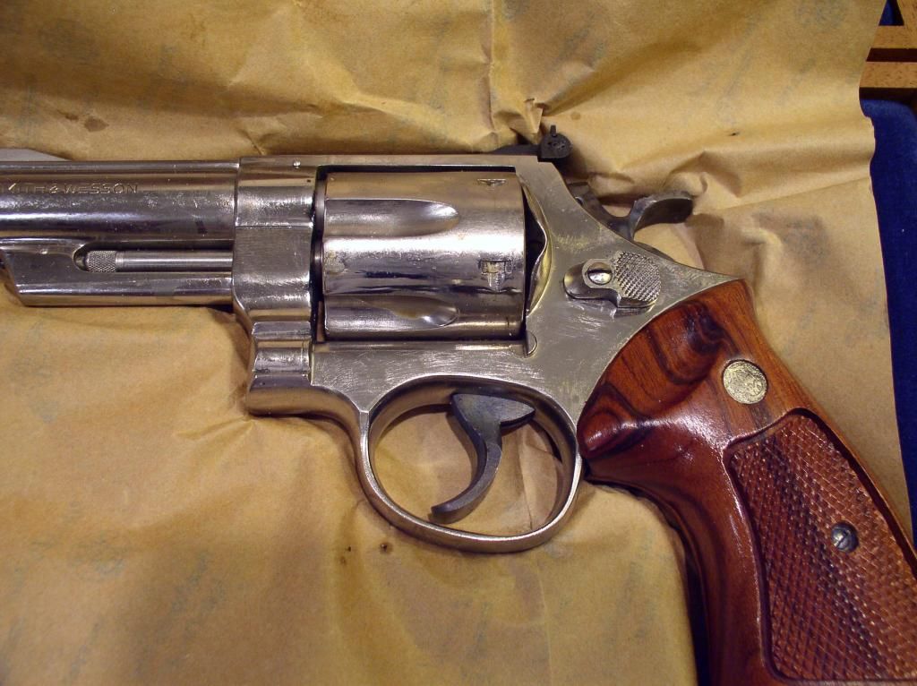

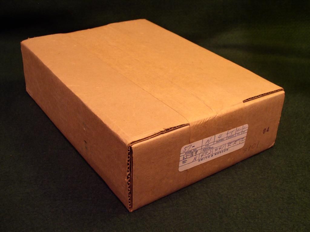

The Smith & Wesson revolvers are from 1976 to 1980, both blue and nickel. All are N frame models, and all were shipped to me sealed in the Smith & Wesson shipping carton of that era. Of the ones I have un-sealed, each gun was covered in a film of grease, which still had some viscosity left. It is a sticky grease, almost like a sugar substance on the guns. Because of the remarkably good condition I found the guns in, I have kept a good number of them sealed. I have attached a few photos from my Smith & Wesson collection.
I believe the Smiths were greased and packaged at the factory in a manner that offers very excellent long term storage.
The fact that all of this family’s Smith & Wesson N Frame Collection, about 75 to 100 pieces, remained sealed, further supports my believe that the Colts were likewise not opened or handled during the time they owned them.

Smith & Wesson Model 57 - Factory Sealed Since 1977:
Smith & Wesson Model 57 - Unsealed Showing Factory Grease:

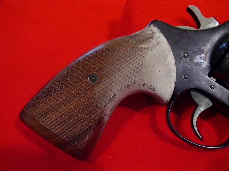

Bought a 6" Python shooter from a pawn shop a couple of days ago. Not sure how it was stored but it has some serious damage to the right side. Also there seems to be gold in the roll marks but I can't remove it with acetone . I'll try to post a picture but have not yet mastered Photobucket.
Interesting that the S&W Model 57 was shipped inside of the presentation case. I had always thought that when a gun was ordered with the PC option, (or it was standard) that the PC was in it's own box, the gun came in a plain blue box without the standard end label, and the whole thing came in a master carton. Do you think the shipping method changed over the years, especially if reports were coming in of the interiors of the PC's being damaged by the guns during shipping ?
Yes, the Smith & Wesson shipping style changed during the 1970s for the N frame guns (Somewhere between N650000 and N800000 or about 1980). The packaged Model 57 in the photo, was the typical style during the middle to late 70s, just the mahogany display case and no separate blue or silver box. In about 1980, the N frames were shipped in a larger cardboard shipping sleeve, as you have noted, which contained a mahogany case along with a blue or silver box with the gun in the small box. I too have heard the same explanation, that the tools in the display case were known to loosen and ding the revolver during shipping, thus the need to ship the gun separately.
