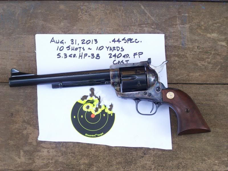

I fired this target last Saturday. As you can see it groups high and the rear sight is as low as I can get it:
Now, in examining the rear sight it does not seem bottomed out, but the elevation screw seems to have bottomed out. Should this (Colt Accro) sight bottom out on the frame? In other words, is the elevation screw too long? I can see the bottom of the screw in the frame, don't know if it would pass through or not if the hole were opened up. I know the screw passes through far enough to score the cylinder on a Ruger Blackhawk. If this were to be the case, the screw could be shortened.
Anybody's suggestion would be welcome.

Looks like your barrel is two inches too long on the top gun:) Seriously, it appears that the rear sight is not adjusted all the way down. If you can press the sight down, your screw is not all the way down. I had the same problem with a NF .22.

Well, the rear sight elevation screw is bottomed out. I can see it flush with the underside of the top strap. And this sight has no "spring" to it.
My thinking is that I might be able to shorten the screw to allow the base to bottom out in the frame mortise.

I was seeking advice on how to lower the rear sight. As I said, the screw seems bottomed out, while the rear sight boss is not. The elevation screw seems captive in the base, there being no "spring" when the sight is elevated.
I do appreciate the advice, though I wanted to keep my pet load as it works in all of my other .44 Specials. I suppose a trip to my gunsmith is in order.

try a different bullet, 200 grain. but to me that gun is shooting good. if you move out to 25 yards it will be shooting even higher. a 200 grain bullet will bring the groups down as i'm sure you already know. nice single action. and yes looking at the picture it looks like the rear sight has more room to come down. I wonder if there is something under that rear sight keeping it from going all the way down. a burr maybe or a high spot on the frame?
6,629 Posts
There is a chance that the sight spring is what is causing the sight to not go any lower as the spring is fully compressed. I would check that first and see if removing 1/4 to 1/2 coil would allow it to further down. You could see if its the spring by simply taking out the spring and seeing if the rear sight goes lower with the elevation screw installed.
Now that's the kind of response I was lookin' for!
