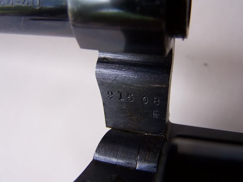

Also note that this is an old style frame with the newer style lockwork. It has the hammer block inside. Wyatt Burp told me he thinks only a couple thousand of this type were made. This one is serial number 21873.

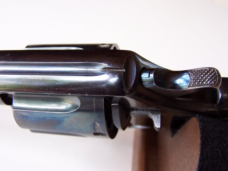

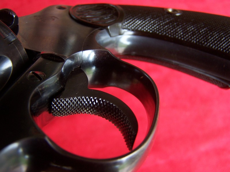

Note the blue on the hammer top. This is also on the back with polished sides. Not fire blue like Colt used to do but still very nice. The trigger is the same way:
The crowning and front sight placement seem to be very well done.

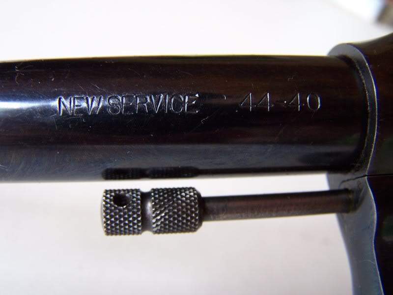

Comparison shot with my 1903 New Service in .45 Colt. Note the difference in sight hieght:
Comparison of the top straps. Note the differences:
Note the differences in the style of hammers:
