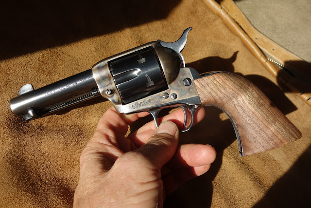

These next two are not true one piece grips. They are made with a spacer...usually but not always wood.

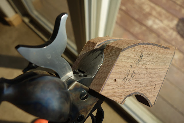

These are true one pice grips. Left and right panel gut from one pice of wood wit the space between still intact except for the groove milled in the block of wood for the trigger guard and back strap channels.
Hard to imagine a more durable SAA grip than true one piece, walnut. Always wondered in the early days if ivory was ever cut as a true one piece grip? I've seen some pretty early ivory here on the forum and few, if any a true once piece set. Anyone care to share pictures and dates of what they have on early once piece ivory or any exotic or checkered wood once piece?
Now every Italian clone shows up with true one piece walnut grips. There was a day when I couldn't wait to take them off and add something "more" durable and pretty. Like the antiquated SAA that we all admire, I have just started to understand the genius in true one piece grips.
Who (besides Uberti and Pietta) in the world today offers to fit true one piece grips besides Dave Lanara and Colt?
Are they true once piece or built by adding a spacer?

Dave's being kind tell the truth. But I do appreciate the comments guys. I've only done 3 pair. With Dave' blanks it is easy to do a couple pair in your spare time while not having pressure from a customer waiting. Being able to cut into the back strap and trigger guard metal to get them right then re-blue really makes a difference on how well they get fit. And how quickly they can be done. I've fit many pairs of ivory and some pearl by taping the frame off...and it is a time intensive, delicate PIA. Always liked getting ivory perfect...never really liked working in wood. But have to say walnut (Dave's blanks in particular) is fun to play with and really fast and easy by comparison to work with.
I did the 4" gun's in 2hrs late the other night. May be another hour sorting out the final profile and wood to metal fit the next day. But under 3 hrs total for sure. Gets easier and quicker every time. I used Tung oil on these but have also use boiled linseed oil. Tung oil I just wipe on and let dry 30 min to an hr and wipe of the excess. Multiple coats when I think about it.
