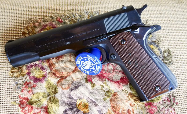

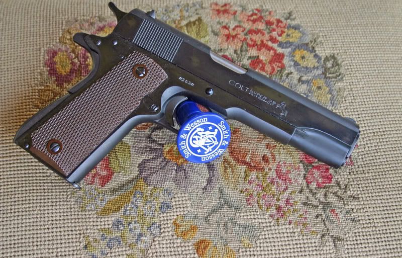

Here is my circa 1947-48 1911A1 38 Super... The roll marks seem a lot sharper on this gun.
The early post war guns used at least some left over GI parts from cancelled war time contracts... not as nice as pre-wwII but not bad. Apparently Colt's was trying to push as many guns out as they could using materials at hand after the war when materials were still scarce... probably using parts on hand when commercial production stopped for WWII.

OP's gun is refinished with soft edges. Look at the 1911-A1 finger reliefs. Should be dead sharp there.
