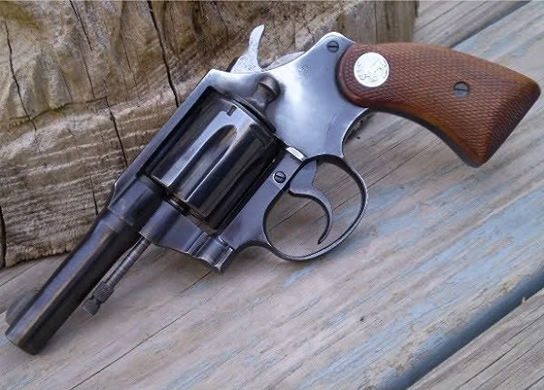

Courier in .32 NP
A previous owner attempted to remove the finish from the frame and cylinder. Stocks are rough, but medallions replaced. Go figure.
Mechanically sound. Should be interesting.

Open to ideas on "re-blue" of alloy frame/cylinder. The Courier was Colts' only mass-produced revolver with alloy cylinder. (Air Crewman wasn't mass produced.)
Bill

The problem is that the alloy parts cannot be re-anodized if the steel parts are in place. Removing the barrel is very risky on an alloy-frame, due to the risk of cracking the frame and/or the frame threads coming out with the barrel.
You will have to live with it as is, or paint it. I have had some success with "Aluma-Black," but it will not "take" if any trace of the original anodizing exists. You have nothing to lose by trying it, except a few bucks to buy the product.

Here's the "after" photo. Not satisfied with the sheen/texture on the frame cylinder. Tried to get to semi-gloss, but ended up with satin. Steel parts were cold blued with Oxpho. Re-checkered and re-finished the stocks. Not Swamprat quality, but have to start somewhere to learn the skill...
Here's the "before" photo
Bill

Thanks for the suggestion. I'll try that next time. Used Minwax Olde Maple poly on this set.
Bill
Pardon my ignorance, but what did you use on the frame. The revolver looks very nice. The stocks look very nice, wish I could do that!!
The frame is refinished with Duracoat. Two part lacquer from Lauer. Thought their gloss black was too glossy, but semi-gloss was too flat. Tried 50/50 since I had both on hand. I think that 75 gloss /25 HK semi-gloss may have been a better choice, but once Duracoat sets up, its tough to remove.
Bill
