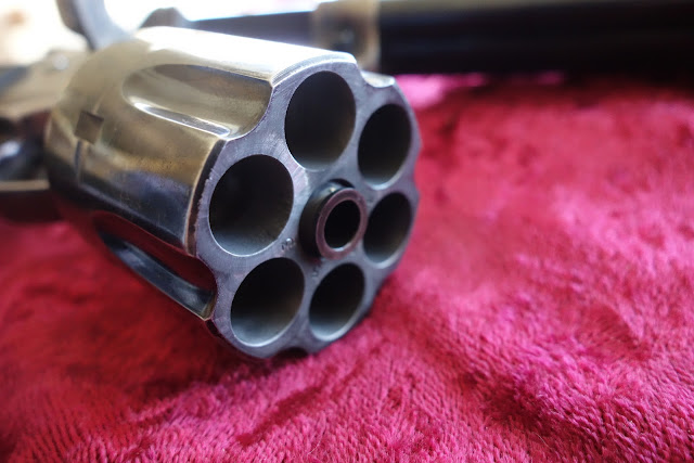

rebore a 38 cylinder to min .45 spec, bevel to 1st Gen specs and bore for a removable bushing

The gun shot well with the original cylinder... which was poorly aligned in at least one cylinder and throats cut all over the place from too big to too small. Gun shoots well at 25 yards, but could shoot that well at 50 yards with a better cylinder. The flier rounds hitting at 5 and 7 all to often should disappear if I do my part with a better cylinder installed. (I still flinch and drop some at 5/7)
It will shoot a whole lot better and be way, way more consistent with this one.

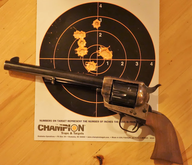

New targets tell the real story. Photo doesn't do the gun justice though. Couple of my buddies were "nay sayers" on these projects. But I'm pleased with the results. These are my best off hand target today @ 10, 15 and 25 yards with Unique and a LSWC 255gr bullet. Time to start reloading 45 Colt brass again :)
"Civilian version of the Colt Single Action Army on a cross pin frame". Project complete :)

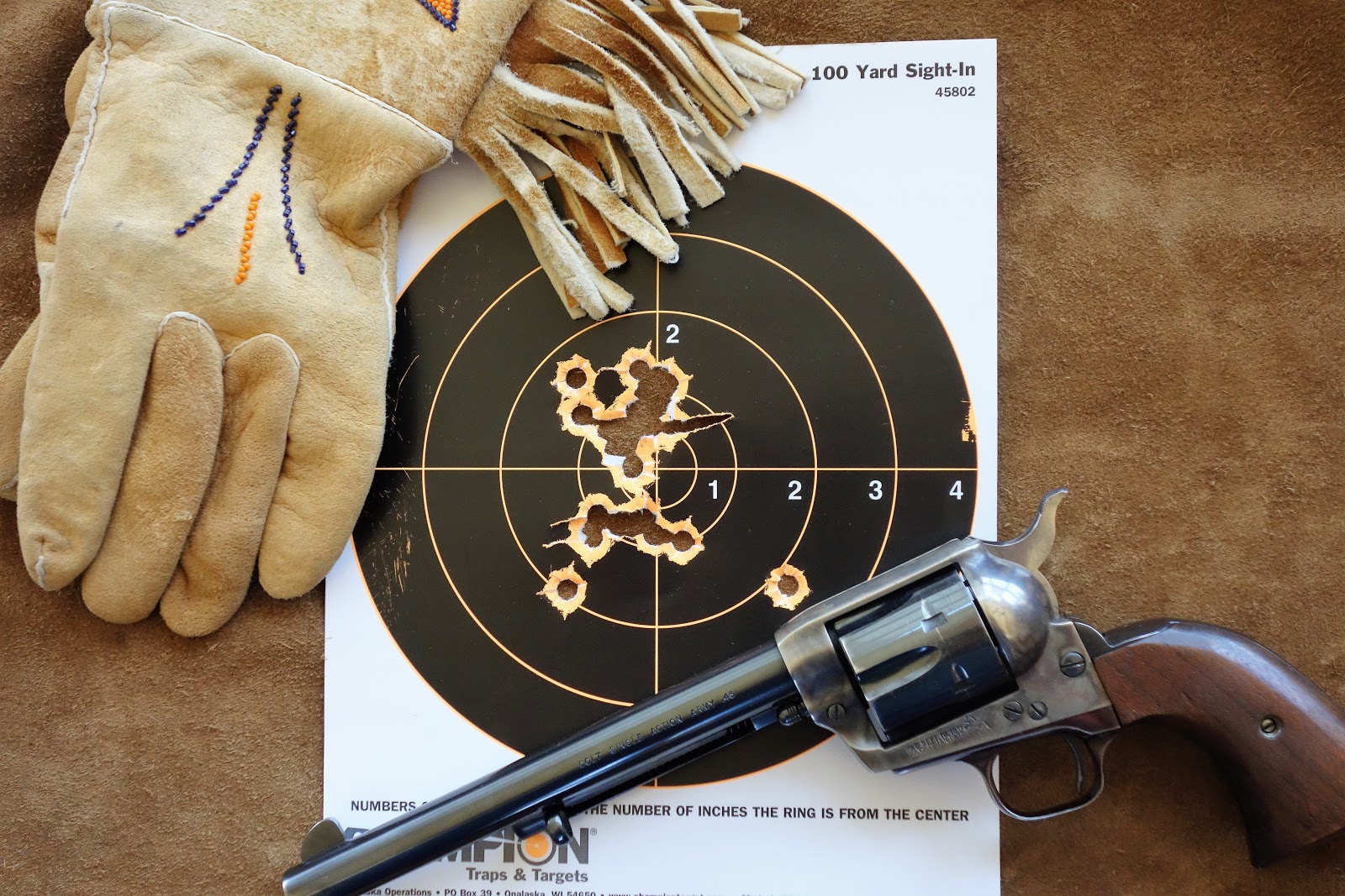

I have one Series II Colt Single Action Army - a 1962 4-5/8" .357 Magnum. It isn't the prettiest gun I own but I like it the way it is! It shows signs of normal wear and tear; and it even has a name electro-penciled under the grips. It still has case coloring so I will leave it alone...for now! Not to steal the thunder of your excellent photos and breathing new life into a good shooter, here are a few pictures of mine....
