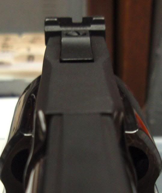

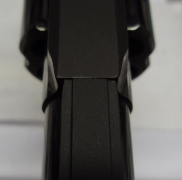

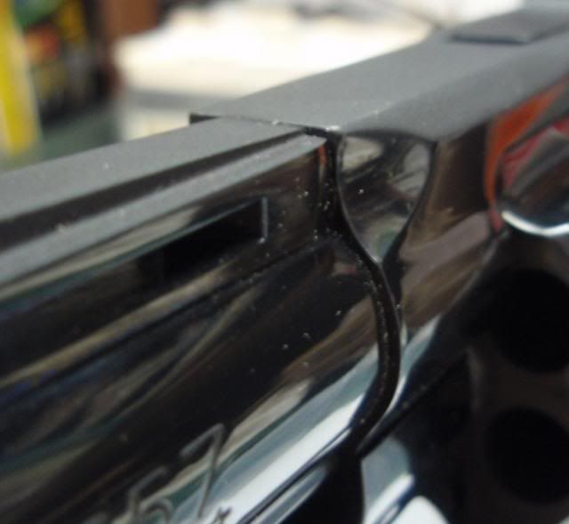

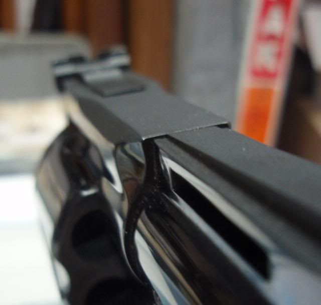

However, I was wondering why I was shooting off a rest and I kept shooting right. I adjusted the rear sight to the left until it was way off center and finally I was close to being on for windage but still a bit right. I took a close look tonight and the barrel is not on straight, the front sight is canted to the left. I brought them a new, unused barrel and they over tightened it.
So I will be stopping by Hartford, CT Monday morning to see what can be done. They have no barrels so I suspect they will have to shorten this one a thread.
You can see in the pics below the top rib is not centered, closer to port than starboard. Notice the rear sight well to the port side.
