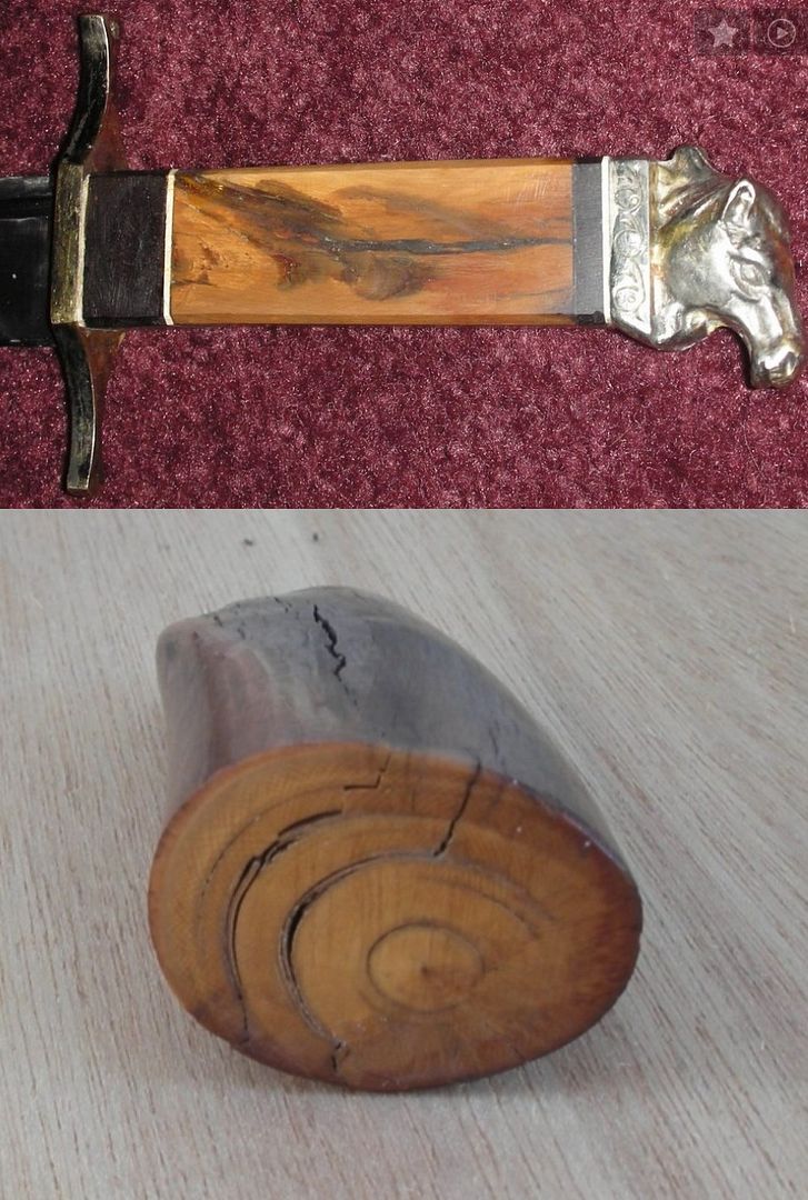

Knife handle & fossil ivory I made it from --
The fossil ivory works much the same as modern ivory, hardness, brittleness, etc. The principal difference is its shrinkage & separation along its 'grain' lines (for lack of a better word); seeming similar to wood lines seen each year in life of wood in a tree. I filled the separations with epoxy tinted brown. My experience with fossil ivory is limited but with modern ivory is extensive.
