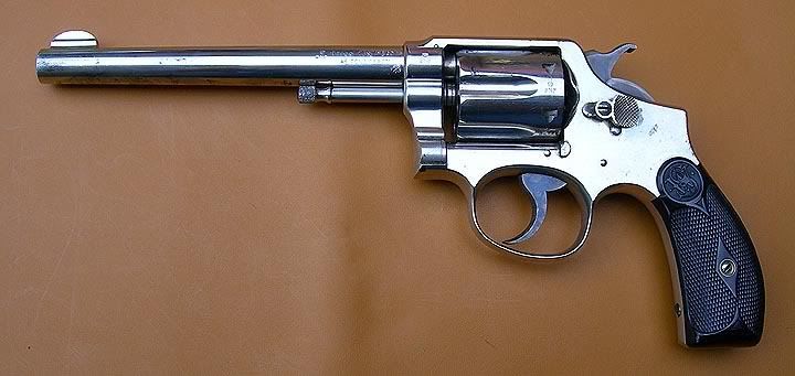

What was the shipping date of your S&W? The British proofs are post 1954. What are the letters at the 9:00 and 3:00 position on the crossed scepters?
Beautiful pistol.
JohnnyP,
That is interesting, I always thought it might be a "Battle of Britain" gun, but I guess not!:(
The 9:00 position letter is P and the 3:00 position letter is B.
This gun is a S&W 32-20 Hand Ejector 1st model introduced in 1899. It is one of the first ones produced; serial number 117, shipped on March 6, 1899 to P. B. Bekeart & Co., San Francisco, CA. I bought it at a Houston gun show in 1981.
12,740 Posts
The PXB would indicate the pistol was proofed in 1964. Bear in mind that the proofing only took place when the firearm was to be sold commercially and not when it arrived in England. It could have been a B of B gun, but through unknown circumstances did not reach the commercial market in England until 1964.
Very interesting and nice revolver.
