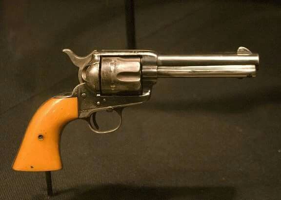

John Wayne spent much of his later career wearing this gun or one very much like it. 4 3/4", .45 Collt/Colt and the yellow Calalin grips on a well worn gun with little finish.
The JW Colt pictured above is in the National Cowboy Museum. No question JW used other guns. A 5.5", 38-40 is a stand out with a Bisley sized trigger guard for one. But the 4 3/4" guns with those yellow grips was his signature gun for many a hit movie for John Wayne.

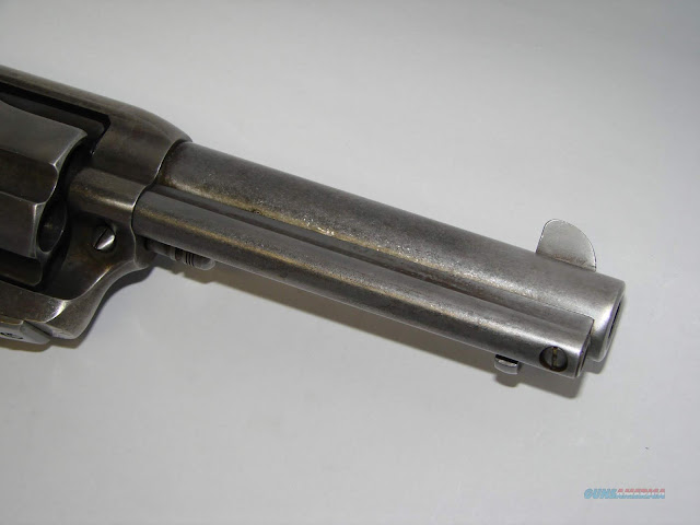

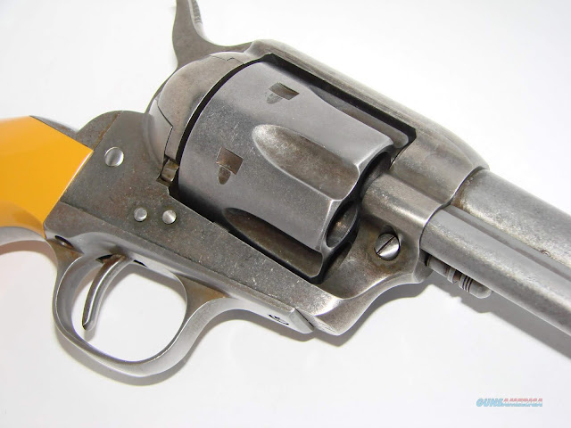

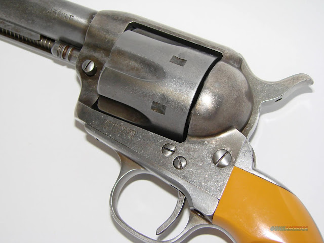

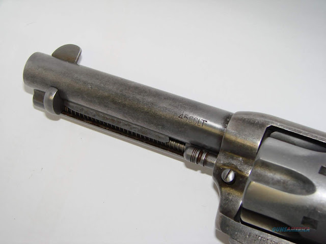

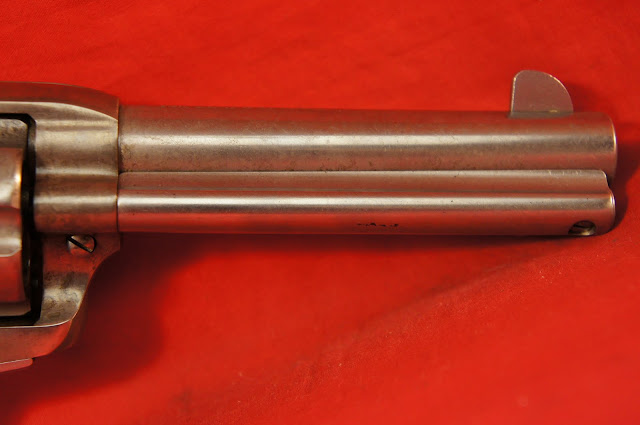

The Cimarron "Rooster Shooter" comes with a Cimarron "original finish". Which is in effect "no finish". Mine came a little, let's say, "over buffed" to be kind.
I didn't take photos prior to my gun's make over but these photos are a spitting image of my gun prior and just a few serial numbers away. Obvious to me it is the same process and very, very likely same gunsmith doing the work on both guns. My gun is #0852 . The gun in the photos is #0863
# 863
some serious buffing there

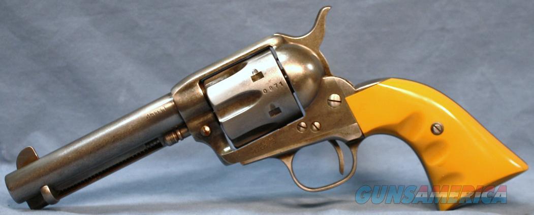

#871 is a little better with "some" finish still intact. Still way over done as an "antique finish" IMO.

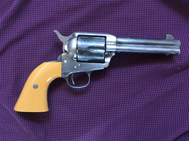

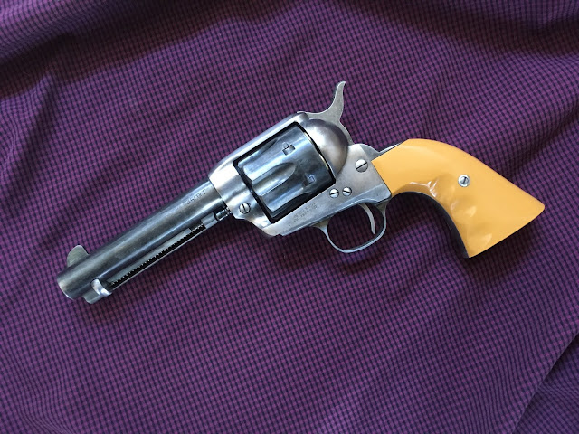

After yesterday's effort I decided the "Rooster Shooter" would need s make over if I was going to keep shooting it.
before
after...with more yet to do.

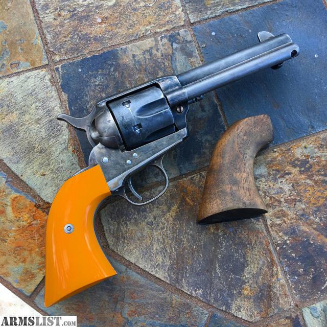

Another effort with a Rooster as the base...I like it.
