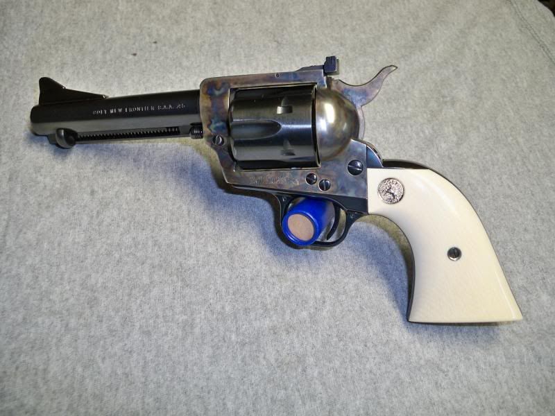

Here are a couple pics of my 3rd gen .45 New Frontier. This one has been to Bowen for a full workover including getting the cylinder replaced with a .357 cylinder that has been reamed to minimum .45 specs. Also had him send it to Paul Persinger for a set of ivories while it was there and also had the hammer CCH to match the frame. This is one that I am thinking about selling .

Sweet!!! They look so much better with a case colored hammer and I'll bet that one's a fine shooter!
Thanks, I have always liked the look of the CCH hammer and BP chamfer cylinder on these Colts better than just being plain. It is VERY accurate, I have only shot probably 100rds thru it since I got it back, it basically just makes one tatered hole for groups.
The only place that had them in stock was Peacemaker Specialties, Eddie Janis. I did two guns at the same time (the NF pictured above and one SAA) and used a .357 for this one and a 38/40 for the other, both were used for .45 chambered cylinders, looking back, I should have used either 38/40 or 44/40 for both guns as they were cheaper than the .357 cyl and accomplish the exact same thing.....live and learn.

That gun is just about the way I would have one built.
I'm surprised a .38 or .44WCF chamber would clean up with a .45Colt reamer.
