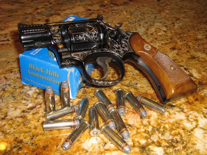

No re-Blue is called for, if one wants the incised/engraved lines to be silver color. And, sometimes things are done this way.
Here's what that looks like, for the OP's reference.
