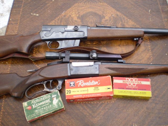

I was discussing Remington Model 81s in .300 Savage with Chaffee here who just got one and decided to verify that '03 Springfield stripper clips worked in them. I thought they did but just double checked and they work fine. Maybe this is common knowledge to other Model 81 0wners. I don't know. Here's a couple close ups and a full belt of military .30-06 for effect. Note that this works because the rims are the same. Don't know about the other calibers like .35 Remington.

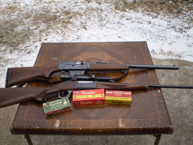

Great looking rifles. Looks like your 99 is a model EG. I'm 99.99% sure. I have one with no finish but also wears a Stith scope mount with a Lyman Alaskan scope. My EG has a perfect feel and LOPull for me. Here's those stripper clips. Ignore the writing on that one. A previous owner years gone by did that.

Wyatt: All I know about that Savage is that it was made in 1950 according to the #. It has an El Paso Weaver K2.5. The 81 was made in Dec 1945.
