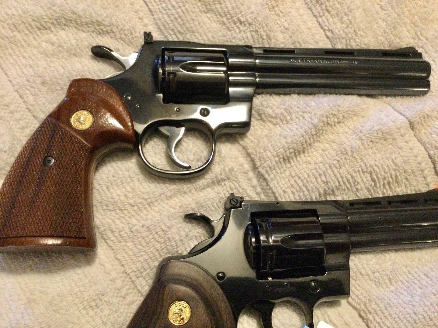

6” 1979 python on top
it’s got to be outside or in some good photo booth type lighting to see any difference in the two finishes to me. Sun is down and indoor overhead lights just make glare.
the deep glossy black is there and present on the new gun as well. For this price point they met, I say well done, Colt.
