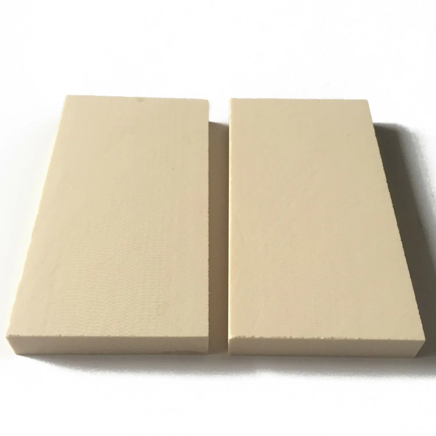

These are Resin + I think they were called. The come in a slab and you have to cut and fit them yourself. Perhaps another member will remember the source without me having to back track a couple of years to find it. I think the man's name was David Werther or something close and his company has something to do with making guitar frets. Can't say anything about the softness or hardness however. They may not survive hard use. I have shot this gun several times with the grips on it with no problems. Hope this helps some.

A number of grip makers seem to think the resin -s is nice. I'm made a few grips from it. Pretty for sure. Same weight and a very similar feel to ivory. If you never plan on shooting the gun I say resin- "whatever" will do fine. The newest version does have some nice figure and lines.
I won't put the effort into that particular plastic again. It is simply way, way too brittle for my own use. And a couple of hrs of labor lost. It's not the first time.
Q4™ Advanced Imitation Ivory Grip Blanks (guitarpartsandmore.com)

David Warther's Guitar Parts sells the grip blanks under the Resin Ivory+S (Schreger) name.
The S grade shows the end grain feature of real ivory with the Schreger lines - hence the "+S" designation. The Shreger lines form a herringbone or diamond patterning in real ivory and our Resin-Ivory+S™ has this same grain feature. The +S grade also has more of a quarter-sawn ivory grain showing on the face of each grip.
