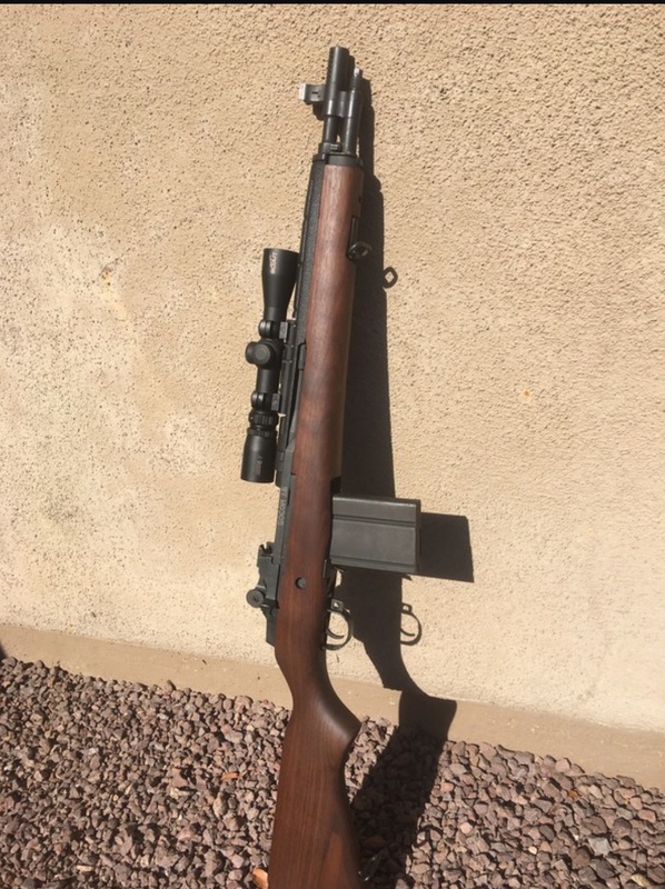

At one time I owned both a SA M1A and LRB M14. I still own the LRB. The M1A was all GI except the operating rod. The LRB is all GI except it has a commercial chrome lined barrel. Both were rack grade rifles.
The M1A shot like a match rifle with groups being 1 inch to 1.25 with my handloads. The LRB will stay slightly under 3 inches with surplus ammo and under 2 inches with my handloads. Although the M1A was more accurate, for some reason I always liked the LRB better. That could be I ordered a barreled action with a head spaced bolt and rear sight installed from LRB. I assembled the rest from parts I ordered from Elmer Balance. The stock iirc I ordered from Fred’s.
Some not great photos of the LRB.
