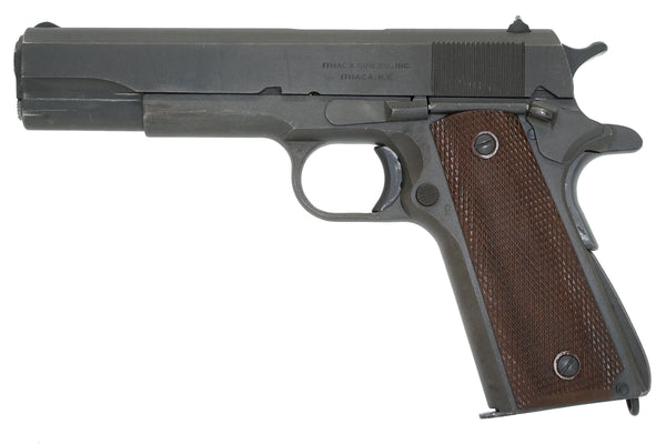

#20 ·
It does look very much like this Ithaca.
#22 ·
Remington Rand slide, Ithaca frame, questionable at best (totally fake at worst) serial number in a range never produced by Ithaca. The one in that serial number not used by Ithaca or Remington Rand. Very close examination of that serial number area may show remnants of a previous serial number. That pistol may be an attempt at faking a Remington Rand demonstration pistol. Caution should be used with that one.
