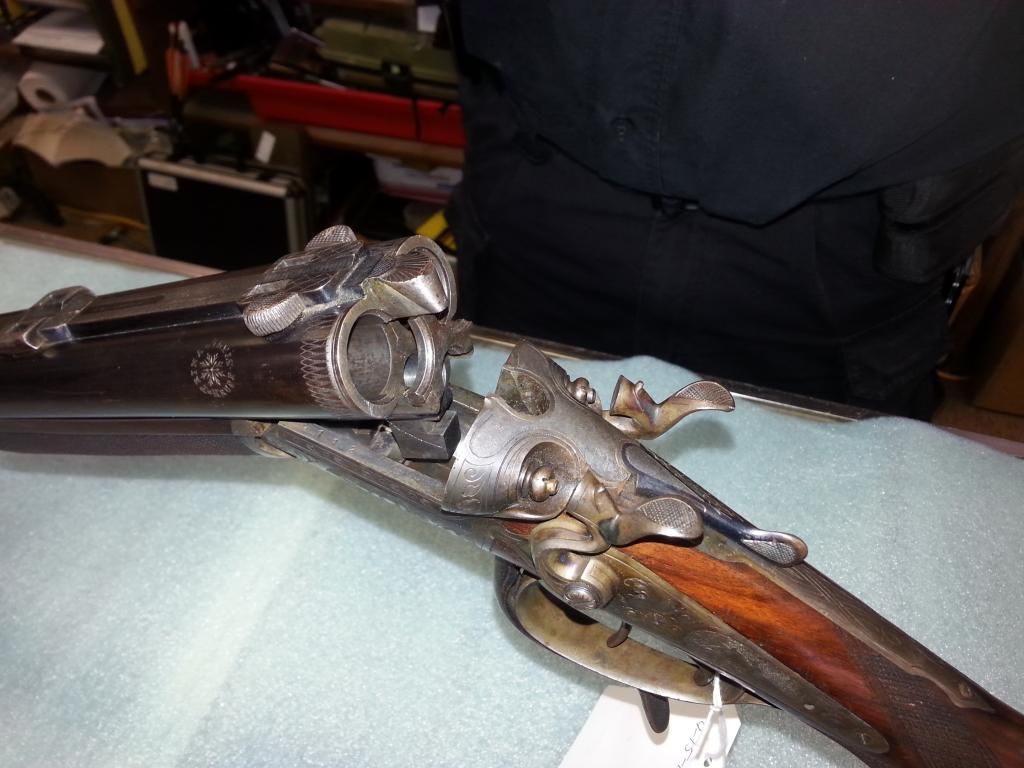

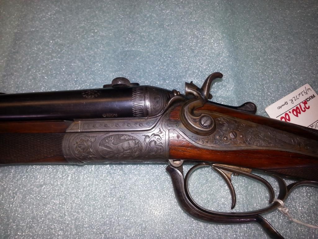

I need some advise on this gun. I have always admired the drillings and wanted one. I found this in a local pawn shop yesterday.
It is German and I suspect pre-war but am not positive. It is 16 ga over the 9.3x72 rifled barrel.
It is under lever and what looks, to Americans, as the release is in fact a selector engaging the right hammer and rifle barrel.
I has a single fold down rifle sight, the mounting points for a claw type scope mount.

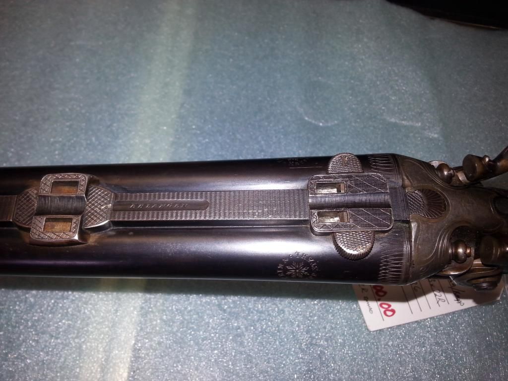

The barrels are marked with the name Erlangen near the scope mounts and "Krupp Prima Stahl" near the breech. The bore and rifling are good, barrels have good blue and the received has good color. The stock has minor handling marks and has a 4 cartridge compartment in the toe. The gun is tagged at $2700 but he admitted that he would do $2200 and I think he'd take two even. I have bought a few other Colts from the same shop and they know that at least once a month I will be through, looking for interesting pieces.
Any opinions on condition, pitfalls, the manufacturer or price? I seems competitive with others I've seen. I am not well versed in the guns other than they are rare here and usually highly individualized.

I have been searching thru GunBroker and GunsAmerica and find similar guns selling in the $2K range & up while there have been sales of less models for less.

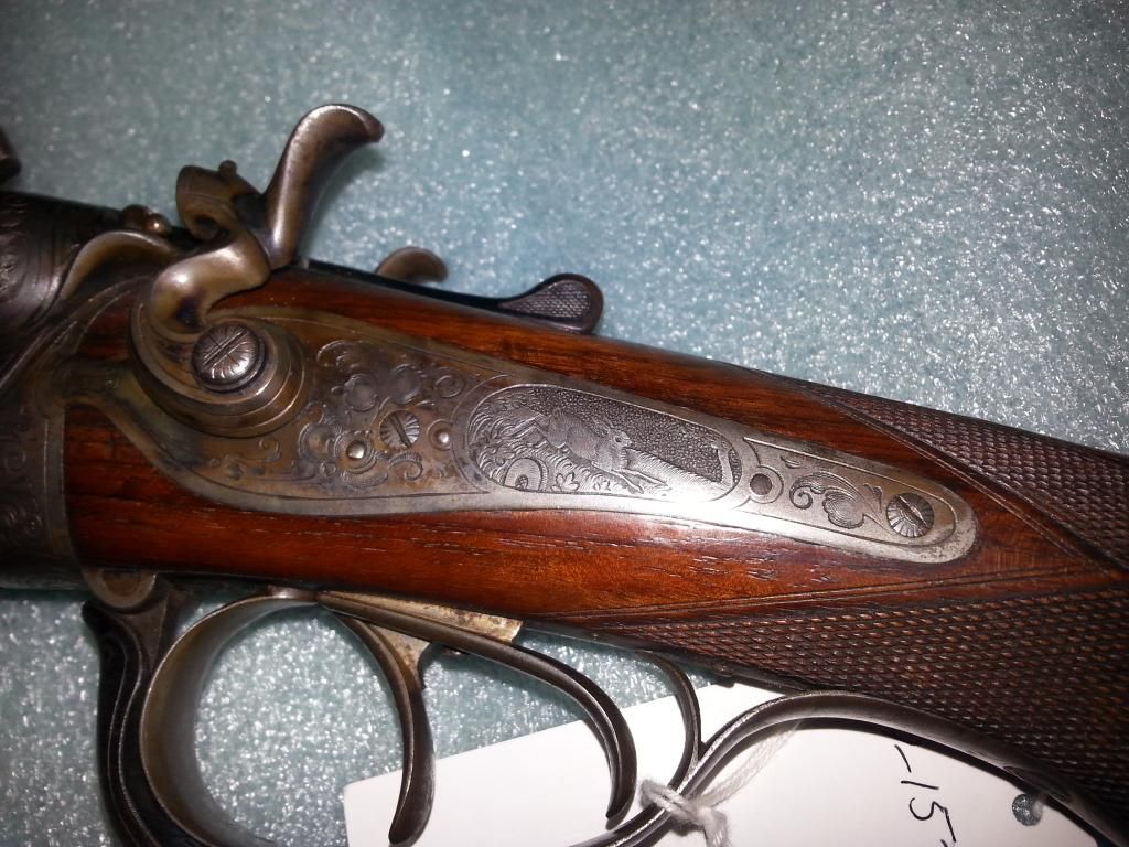

The auction houses I have searched have some listed with projections from the $1400/$1600 to $2700/$3000 range. The Sauer and Krieghoff guns are premiums. And while I have found examples with what appear to be the same action and pattern I have found none with the same names and markings. Of course the engraving varies widely with most having the four different game scenes on the sides and it would appear that the additional animals on the trigger guard, tang or under side of the receiver may have been upgrades.

A disclaimer: I have no special expertise. Just a few thoughts.
This is what's called a Hahndrilling (with external hammers). While a few custom makers still make Hahndrillinge, this one is probably pre-WW 1; most makers switched to self-cocking internal systems in the early decades of the 20. century.
The markings are pretty sparse. "Erlangen" is a town in Germany not known for gun manufacture, and I would guess that "Krupp Prima Stahl" just refers to the steel the barrels were made of; by the way, the 16 ga is most likely what Germans call 16/65, which is 5mm shorter than standard 16ga (called 16/70).
I know nothing about US prices for these. You wouldn't get anywhere near $2200 for this in Germany, since it seems to be a no-name brand; I found one on the website of Frankonia, the largest German hunting arms retailer, with the identical caliber combination plus a scope, but no pictures (so hard to compare), and that had sold for 699 Euros, so about $1000. But then that's across the water, and this one's here.
Thanks for the info on Erlangen. I suspected it may be a city but wasn't sure. The one think that bothers me is no identifiable makers info. And I thought the Krupp markings were about the steel/barrel maker. All of the guns I have found on line or in auction catalogs have makers names and that is the ONE thing I have NOT located on this one. On the other hand, I know that many of the finest early American long rifles from the PA gun makers (the PA Dutch from Germany) are unsigned because that was viewed as a sin of vanity and was deliberately omitted.
Discussion starter · #7 ·
Just a hunch, but I can't see a German gun maker who uses a mass-produced barrel steel with a rather garish barrel marking being too modest about his name. One place to look if it's accessible would be under the barrels in the area covered by the forearm. Most drillings have the snap latch that allows detaching the forearm and unhooking the barrels. If this one does not, I'm out of ideas.
