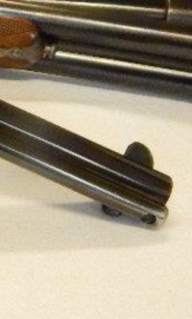

I’m looking closely at the trailing edge of the front sight. I think it does look more like a newer style front sight instead of the canted rear edge of the Uberti parts front sight. No doubt that this should have been all Uberti parts gun being that early of a serial. If that front sight is not original, that explains a barrel shortening and the one line address.
What do you guys think?

The gun in question might have left the factory as a 7 1/2" later shortened to a 4 3/4". No box/label invites speculation.
All in, it does indeed invite some speculation. This is a odd gun no matter how you look at it.
By the look of the lighting in the photos shows an ejector rod housing that is worn. The seller and Ben's enlarged photos do seem to show a lot of wear "
It does have what looks like holster wear on the bluing at the right side forward portion of the case ejector housing (visible in photos). "
Barrel crown is as factory as it gets. And the fact the cylinder end looks unfired brings me back to never say never. USPFA/and early USFA guns were many times literally hand made "as in lunch box guns". In other words they built what was ordered from the parts they had. Uberti didn't start out with a two line address on the 4 3/4" barrels. And I'd bet this is a factory one line address 4 3/4" barrel.
Hard to disagree with the photos. "Buy the gun"...is my punt here. A 100% American made Rodeo can be had in that same price range easy enough.
A few of the reasons, the cast hammers and checkering, and the poorly cut rear v notch sight, is why I don't intentionally buy these guns. Current Uberti gun are better there most of the time.
I'd vote for a clean 20xxx series USFA gun. I do believe the front sight profile (more US than Uberti of the time) is correct for the time frame as most early USFA guns were BP frames. What I had not noticed until now is this is actually a very rare (as in VERY rare) USFA version...cross pin frame and V notch sights. I just bought two USFA guns and don't need a third today. But for any USFA collector if this actually is a V notch and cross pin (we know it is cross pin) it is one of what I think is the "holy graill" USFA guns.

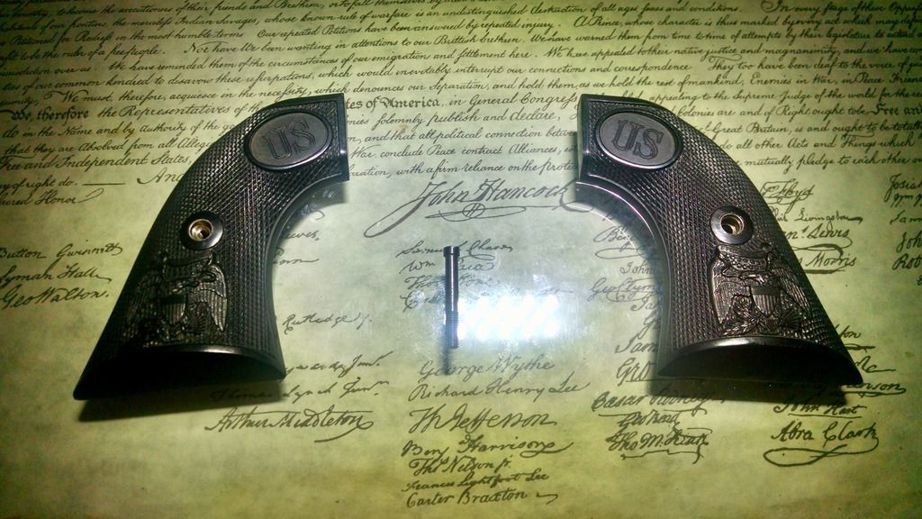

My first thought on the gun was Its an early gun.. lunch box parts type thing too.. I’ve got some early USFA black grips where USFA would take Colt grips and sand off the rampant Colt in the circle and put the US logo in there.. and they left the eagle on it. So no telling ..
But. The more that’s been pointed out, the more I have my doubts. The amount of wear on that ejector rod housing end , and the rest of the gun looks brand spanking new, unfired. I just can’t see the front edges of the cylinder staying that new if the ejector housing is getting holster rubbed that badly. Since they’re not shooting it, the cylinder shouldn’t be getting rotated much and should get a spot rubbed too probably. I tend to find that USFA guns that remain unfired - more often the owner has the box, but that’s not hard evidence since one may keep the gun safe queened and the box gets lost in a closet and disappears one day.
Early USFA grips that started out as Colt grips. CUSFA grips ??? :)

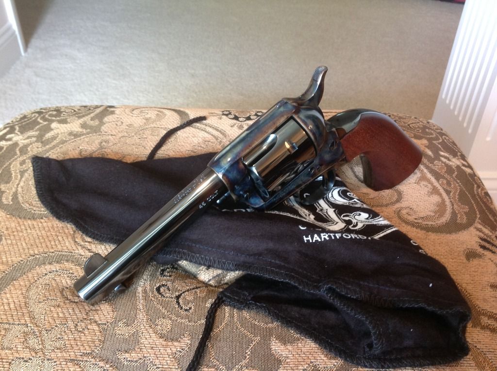

The V notch rear sight groove with crosspin frame is extremely rare . The Uberti frames of USPFA were I think all Vnotched, but all BP framed. So I agree that this gun is rare in that aspect, although looks like somebody or some machine was learning as rough as that channel looks.
That I know of, I have only one gun that meets that V Notch/crosspin frame criteria and that’s my Old Armory Original model USFA. They were the most expensive standard production gun made late in usfa’s career... and as one might expect, not many made and sold not too well when a premium model was hundreds cheaper.

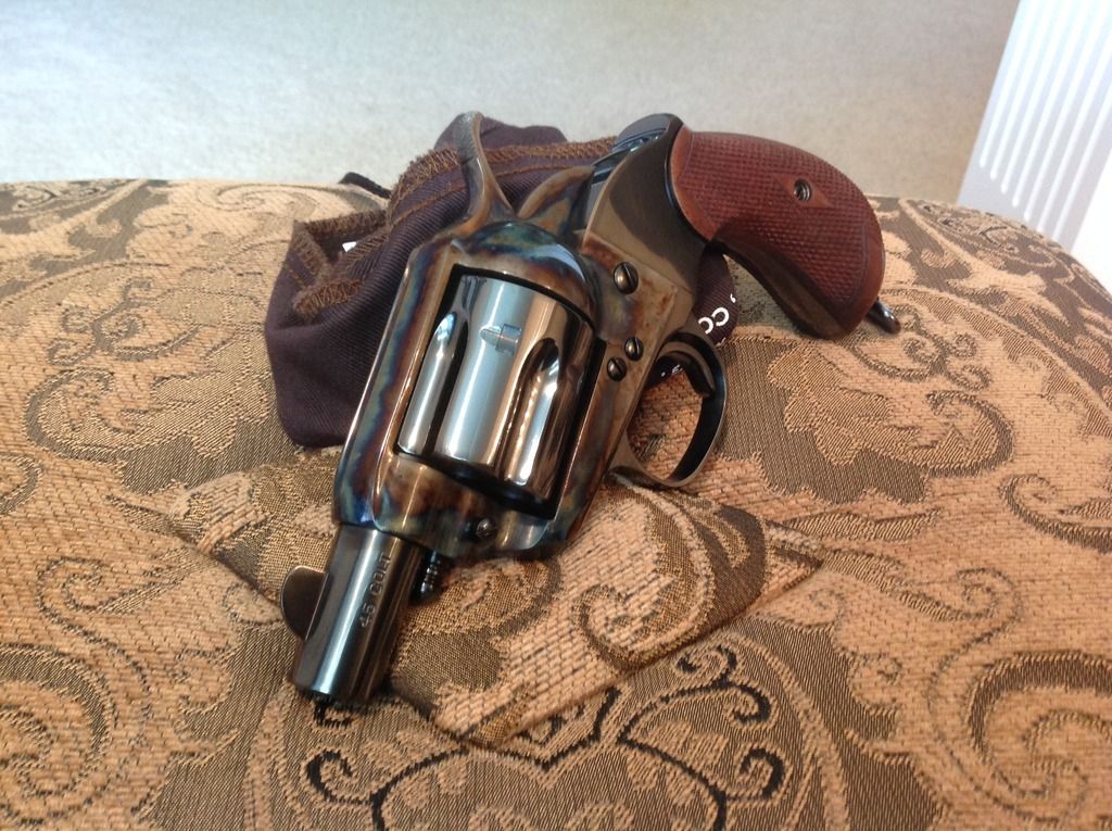

I don’t know if my other v sight/crosspin framed gun counts really, because it’s an Omni snub model instead.
Old Armory Original
Omni snub
