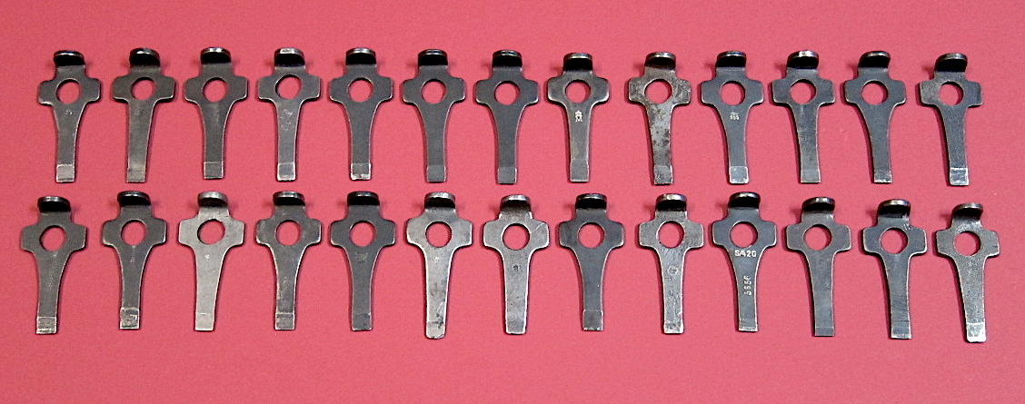

If you shoot a Luger, the most useful accessory/tool you can have. The Luger magazines have a virtually non-existent magazine button, and sharp edged to boot. The tool hooks over the button on the magazine, and your thumb fits on the turned out piece to pull the follower down. The hole in the center consists of two holes, one drilled all the way through, and the other drilled almost all the way through leaving a lip to catch the magazine button.
The screwdriver could be used to remove the stock screws, or disassemble the firing pin assembly.
They were issued with the same acceptance mark as the military Luger, but DWM was very lax in marking theirs.

Daggone, that's a lot of tools (and $$) on the table!
You also need one to fill out a complete rig too even if you don't shoot...
I was fortunate to get an E/135 tool with a recent byf/42 "Black Widow" rig acquisition - I didn't realize how expensive they were :)
(some much more than others).
Are the grooves machined in the back supposed to ride along the ridge in the magazine?
As you might guess I don't know much about Lugers, and it doesn't fit all that great on the late fxo mags that came with the rig.

I believe this is the way it should work, but as you can see mine doesn't quite fit right, the lip inside the tool isn't properly engaging the button and it slips off.
I had a Luger many years ago. Wish I had known about the tool. A shooting buddy got frustrated trying to load and broke the spring.
If you don't have the tool or it won't fit you can slip a 9mm casing over the button to use as a lever. A .38 Special case will also work. It's almost like the guy who designed it knew what he was doing. :cool:

As many Lugers I have seen with their holster, few loading tools are present. It must have been easy to lose or it did not function well.

I would like to have the correct tool for my 1935 G Date Luger but those little pieces of metal with the proper markings for a particular gun can be quite expensive these days. I thought $150 knurled handle Smith & Wesson SAT's were crazy ! Maybe I'll just buy a replica for the occasional times I run a mag or two through it.

The very early Luger magazines did not have the raised center section of the magazine button. They were perfectly flat with checkering all the way across, and especially hard to load without the tool. This lasted only a brief while, and the raised portion of the magazine button was added, and the frame relieved slightly to allow clearance.
