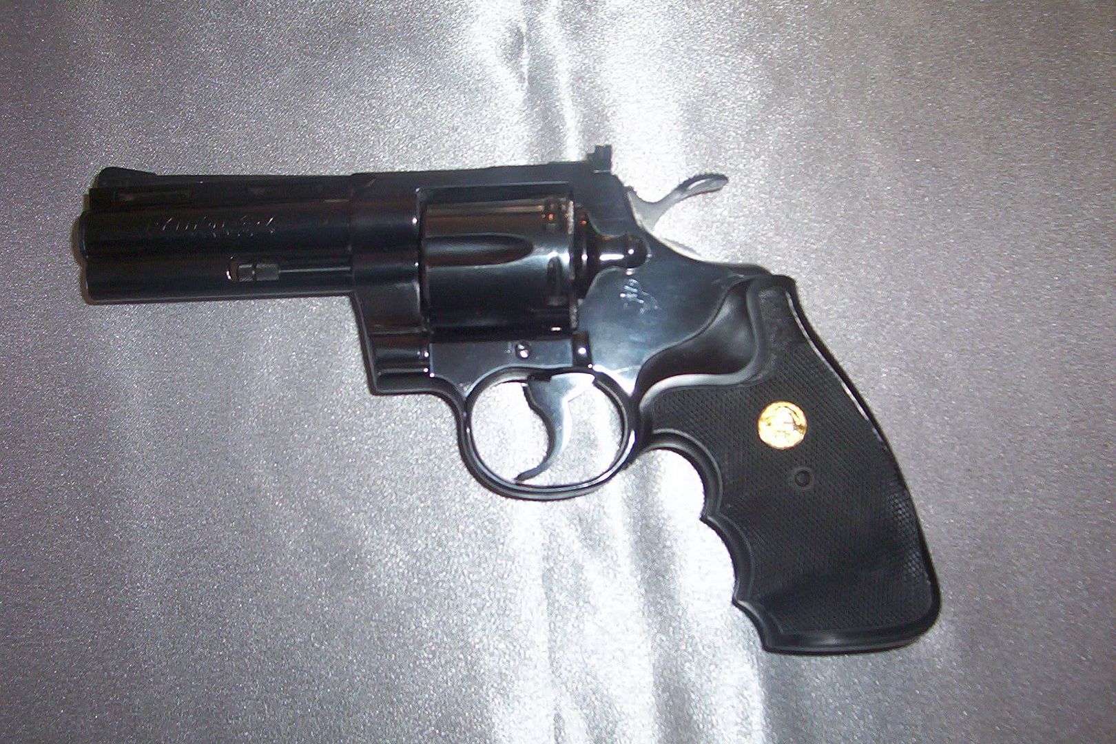

Thanks. The reason I ask is kind of embarrassing but I got mixed up. I bought this 4" Python about in the 1990`s. It was mint but no box or pw. It looked about new. I am almost sure it came with these black rubber grips with the colt gold emblem. Yet I have another pair of period correct wood grips with the colt gold emblem too and aint sure if I got them (or two pair) with the gun or if I bought them separate later. My gun is V 73090 or close. Did the rubber grips like mine come with them in that era? Also the wood, are both correct just with the luck of the draw? To shoot I like the rubber better, to show I like the wood better. I also have a set of faux ivory with the colt gold emblems. My memory is a little foggy what I done as I have several troopers with extra grips too.

Rubber Pachmayr "Gripper" grips were not used by Colt until the early to mid-1990's. They were standard for a year or two on 4 inch Pythons.
The Python "V" serial number series ran from 1978 to 1980.
A Python made during that time would have shipped with Third Type Walnut Target grips.
It's likely very early Pythons had grips numbered to the gun, and those would have been the First Type fully checkered type.
Later, grips may have marks or stamps inside, but these are most likely control numbers used during manufacture and have no relationship to the serial number of the gun.
Since later Colt's did not have fitted grips there was no need to number them to the gun.
