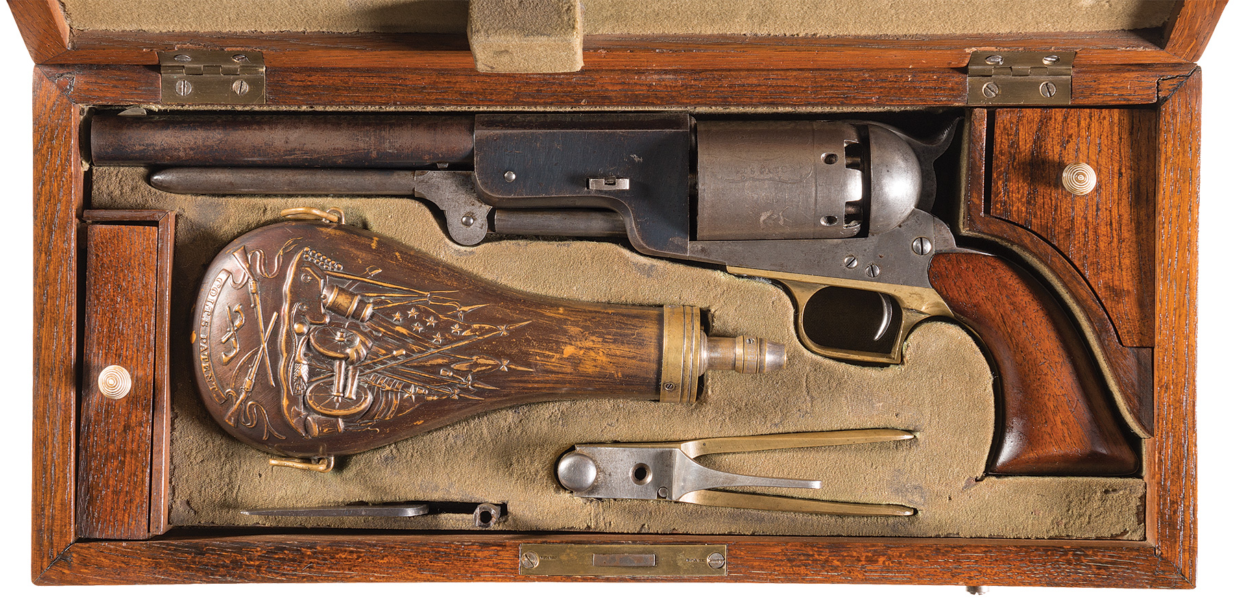

Here you go hope pictures are good, I’m not a very good photographer. The weight is 4lbs 10oz, a little under 16” overall and barrel 9”
it would only allow 10 pictures, I’m sending a couple more pictures in another attachment
#27 ·
Some additional pictures, if you want something else let me know
The loader lever spring is broken, the one pictured is with it ( reproduction I’m sure) looks right but nobody has tampered with trying to change it

Sad to say, I would almost bet my Armi San Marco that this is its brother. The aging looks to localized and too deep. It does not have the overall soft edges and consistent patina of a 177 year old weapon. I hope to be wrong.
For comparison, you can enlarge these images: https://laststandonzombieisland.com/wp-content/uploads/2018/03/danish-sea-captain-walker-3.jpg

Hard to use most of the other pictures for direct comparison to the Rock Island pictures.
All photos of the new item need to be perfectly aligned at 90 degree angles to the markings if better comparison pics are desired.
But the smaller font size on the barrel of the new item is telling when compared to the larger font of known and verified Walkers. No dash between New and York on the new item.
Round bolt notches on the cylinder of the new item compared to oblong notches on the known Walker.
Also, a few very noticeable contour differences of the barrel and loading lever knuckle area.
