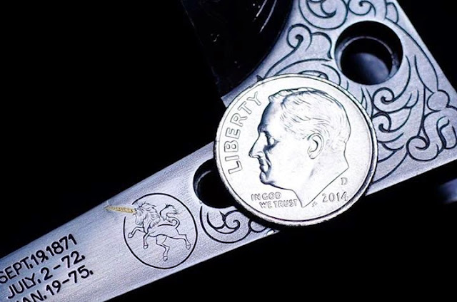

This one was enhanced by the engraver to duplicate a pre 1912 "circle pony" trade mark gun.
742306
I suggested Adam's. But any skilled engraver can chase the patent dates and the Rampant Colt on a frame. I know for a fact that Turnbull quite often uses the Adam's shop for such jobs, having worked with both over the last 30 years. 1st hand, known product, which is why I suggested them.
If the gun is to be eventually engraved, I'd just have your engraver recut what ever you don't like. If the gun is to be left plain and colored cased, I'd not bother, as what you "see" will never show up any way under case colors. If the gun is to be nickeled? Then make yourself happy and get it recut to your satisfaction. Silver plate will fill in any engraving some what, so I'd not bother if using silver either.
